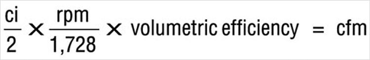

I'm no expert, but you have to take efficiency into consideration. Not even the most extreme race engines are 100% efficient. As per the equation below, 6000rpm at the trap, and 95% efficiency (which i think would be well above what it actually is). You're at about 699 cfm.
That number is the most air that can be pumped through that engine at that rpm. But going on the big side is probably a good idea, I just don't think going too big is going to help you out at all.
Anyone have any comments on my math/reasoning? I'm always looking to learn something new.
the equation i have always used is:
(cubic inches x max rpm)divided by 3456=aprox cfm baseline for nonmodified eng.
about the same as yours,but you remove volumetric eff from the equasion.same stuff used by old school tuners like grumpy jenkins,smokey and many others.the hotter the eng,bigger you go up in cfm.most of it is a test and tune or guessing game anyhow.
