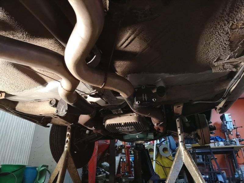

Added the cut outs today.

Nice job with the cut outs.
