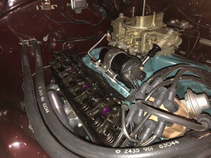

I used a 6 pack coil bracket and bent my own fuel lines from 3/8” stainless.
It looks as though the piece where the two lines converge can be shortened.

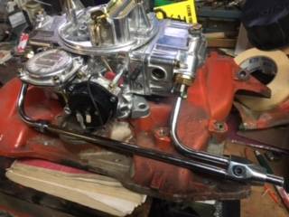

Do you have a spacer between the carb and intake ?
Yep, clearly shows in the picture but here it is by itself. I use to have a thermal break spacer as well, but it was the big open square and I wanted to get each throat running separate this round.

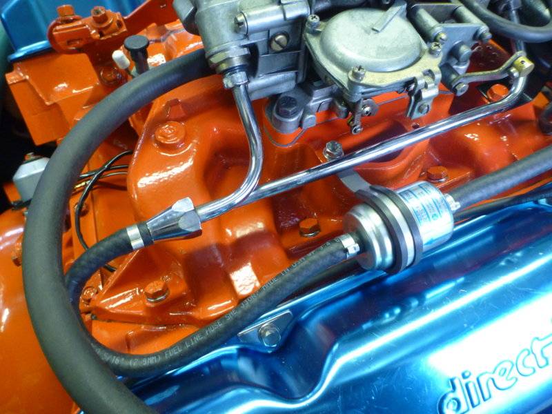

I used 3/8" SS tubing. Made a new line from fuel pump to the inverted tee.

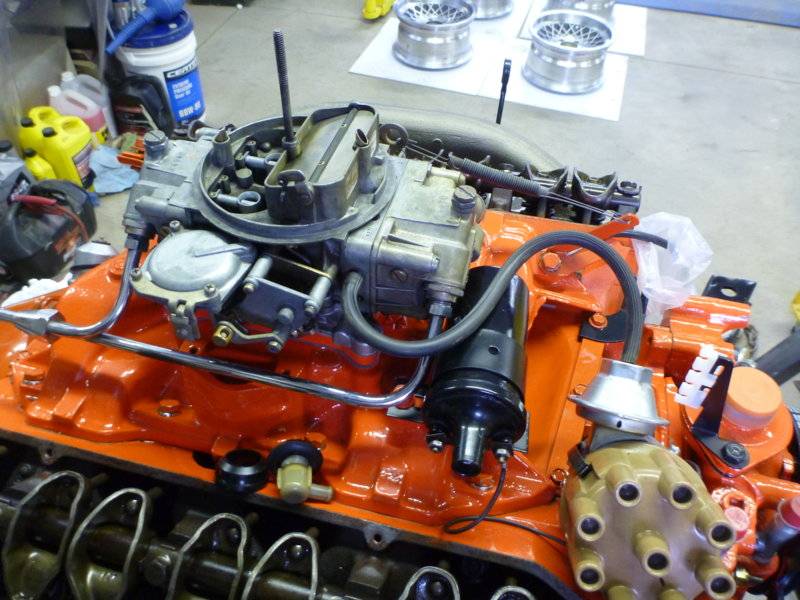

I run a setup very close to the one above ...
"I run a setup very close to the one above …"
Simple and effective.
