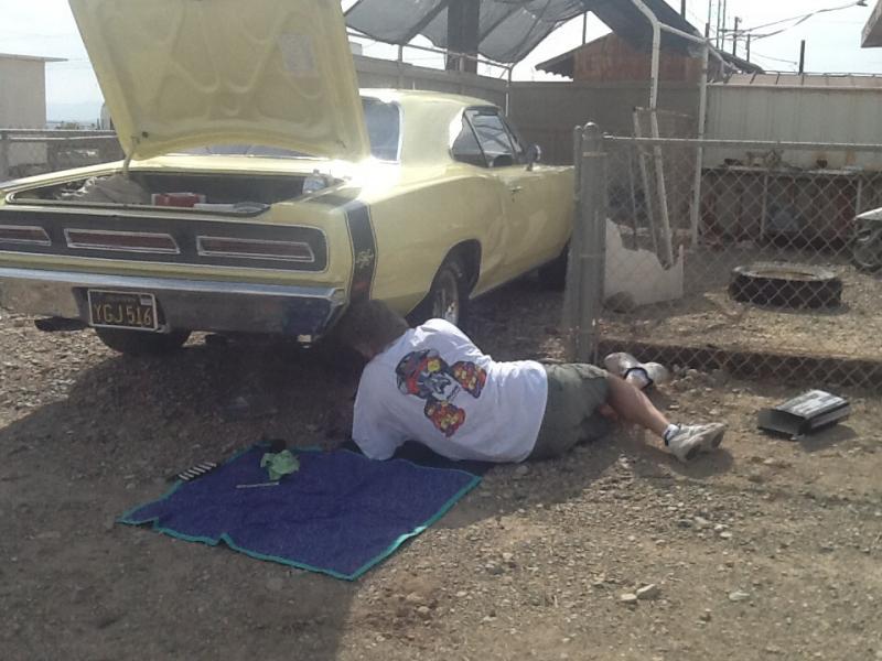

Use dampening material to absorb noise. Mine is one the frame behind the right rear whee, 69 Coronet. image.jpg As shown replacing it on the road. The first time. Carry a spare.
