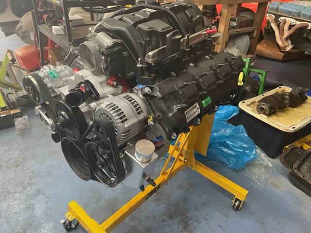

Funny this should come up right now as I am assembling my mid mount system on my 5.7 as we speak. As to the question, I would say that if you are using a crate engine it is absolutely worth it, if you are using a complete donor engine it might be depending on what you want/need.
I like it because it moves the AC compressor up to the passenger side, also since I am using a crate engine I needed the alternator, PS pump and AC compressor anyway. Additionally the PS pump is a type II which will work well with my hydroboost and Borgeson box.
Really the nicest thing about it is that it comes with everything you need, bolts, tensioner, belt, etc. Also it gives you a lot of options such as where you want the heater lines (you have several options), it provides temp sensor options as well and it uses a stock front cover gasket, oh and the water inlet/outlets swivel which allow for a number of radiator options.
Yes it is expensive but I think that if you were to price it all out and given the options it provides it is well worth it.
It isn’t cheap but nothing in this hobby is. I used it because I was adding AC. It also keeps you from having to notch the frame rail for the alternator. I like how it condenses everything and fits everything tighter to the engine. I’d buy another one if I do another gen 3 swap.

A couple of things to know,
You will need a few specialty tools such as a puller and an installer for the front dampener as well as one for the PS pump pulley (you can get them off Amazon). The dampener puller can be confusing because there are different dampeners over the years, I bought one which didn't work and ended up making one.
You have to decide how you want your heater lines to run early on (under the intake or traditionally) because one of the fittings is a 90 deg elbow and cannot be installed once the front cover is on.

Yes you can probably rent the tools, I am not sure because I don't rent tools (given the prices on Amazon I'd rather own them).
As to the heater lines, it might be a bit tight trying to tie into the hard lines that run under the intake and route them to a stock heater core. I am going to be running my heater lines on the outside like stock.
One thing on the a/c moving it does fix the denting the front header tube for the low mount compressor to clear with tti headers. Not sure if hooker headers clear the low mount compressor.
I am sure they would work at least for awhile. The problem there is that the heater lines see a lot of heat cycles and over time plastic doesnt much like it especially with any vibration, however I am sure they would/could work. Personally I just don't think there is enough room at the back of the engine to bring those heater hoses out and back around to the firewall.
