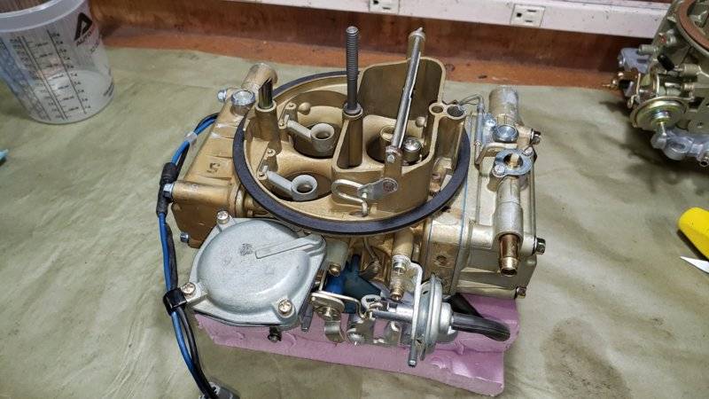

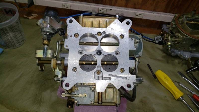

I’m curious to hear how many here are still running a ’70-72 OE HP Holley 4160 650CFM carburetor and what your current experience is with them.

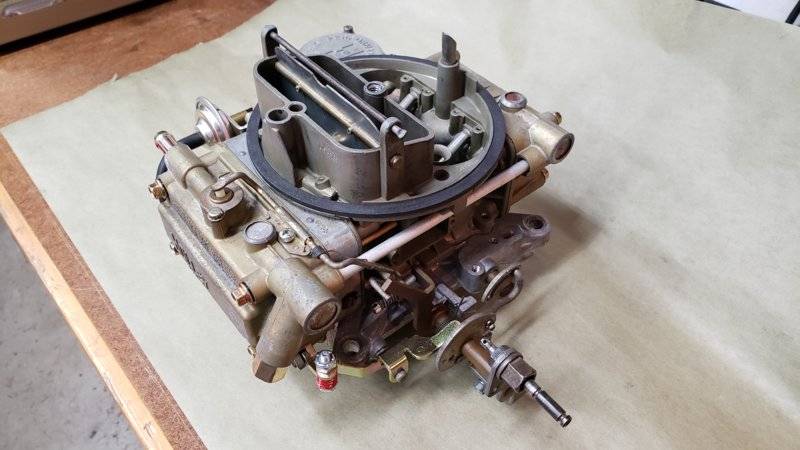

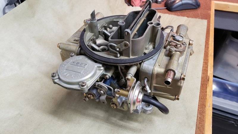

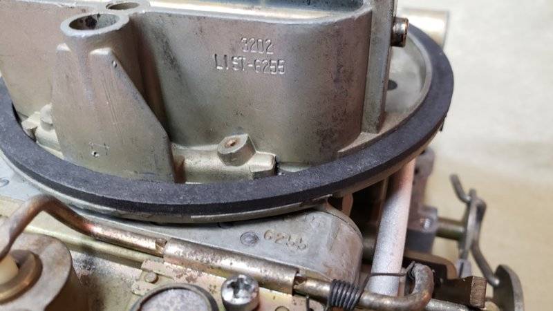

More specifically, the ’72 U-code version, List numbers R6252 thru R6258. Stumbled across a R6255 recently in pretty good shape, rebuilt it and have been testing it on a slightly modified 400. The R6255 is a federal production automatic with N96, fairly rare I would assume.
Yep, the transfer and idle circuits are completely separate. Ran a R4367 on a ’70 383 Road Runner 4-speed back in the day, had a slight off-idle flat spot but otherwise ran well when it had fresh gaskets in it. I’m finding something similar with this one, exploring ways to get at the restrictions.

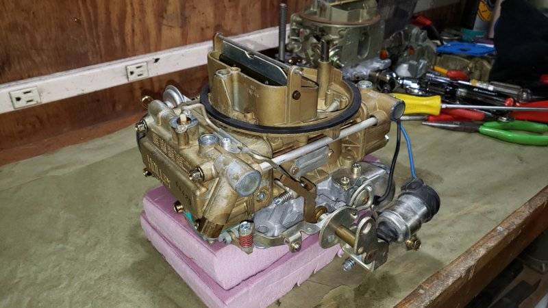

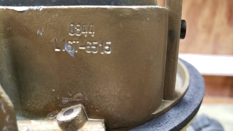

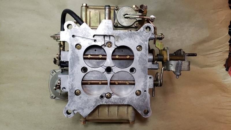

Stumbled across another one, NOS 6515. Build date in ’74, designed as replacement to several OE HP applications. This one has a two-circuit primary design.
