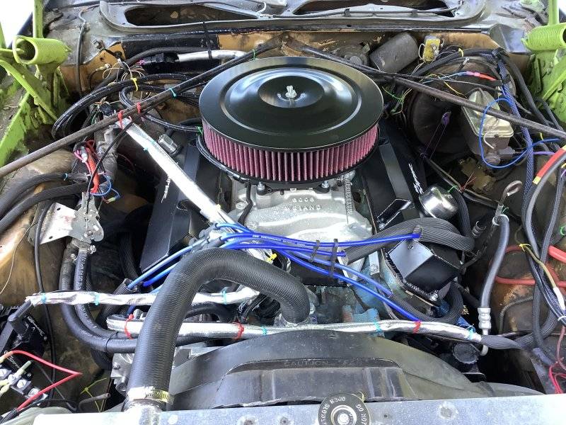

So, a couple of pics of the new motor. I've gone to the Holly Sniper II. My first experience with bolt-on EFI.
My question(s): Shouldn't it start the same (like an OEM EFI) every time? Should there ever be a difference in starting it from a warm motor vs. a cold one?
I'm not the mechanic on this. I had it done 'professionally.' When running, I love it. The smooth pull, etc..

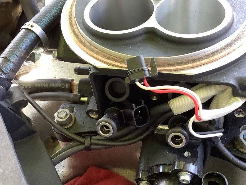

I had an issue with my Sniper for quite some time - always running rich and spluttering etc....fouling plugs like a two-dollar hooker running on two-stroke .... I digress.

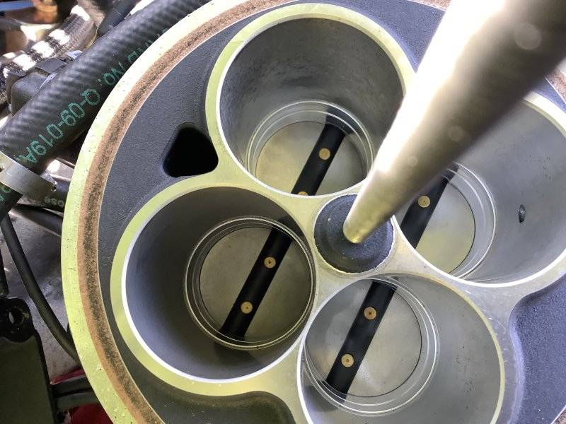

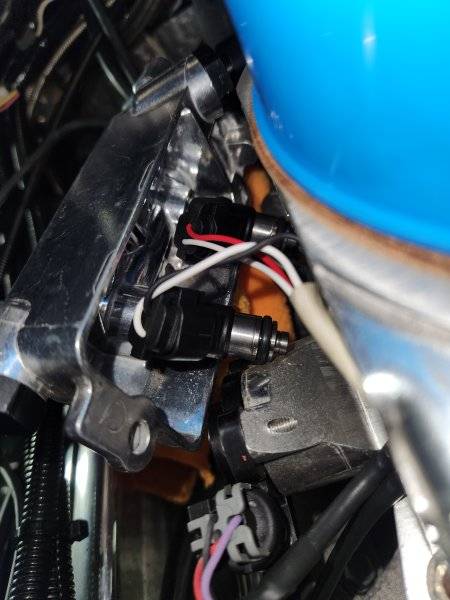

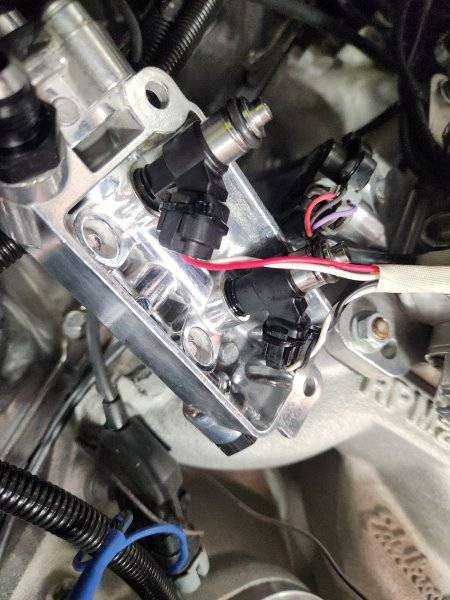

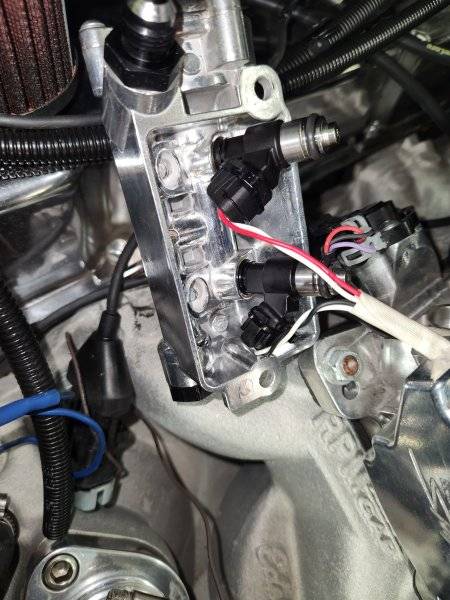

Turns out I had the 'common problem' of the injector power plug falling off inside the side covers. It took a while to find a few videos that showed the problem and convince me that was my issue. Sure enough I looked down the throats and one was bone dry and not shooting gas. I dismantled the side covers and made a 5-cent fix on all four injectors - a zip tie. After all I am a Certified Zip Tie Technician. :lol: It says so on my work van.
Here's my video....and pics
*****WARNING - this video contains content that may offend @Kern Dog (filmed in portrait) .... shows the 'dead' injector - and also shows it's mate on the same spindle shooting extra fuel to try and compensate for the lack of fuel in the dead one. That was giving me the rough running and idle plus poor fuel economy and fouling the plugs....nasty really.

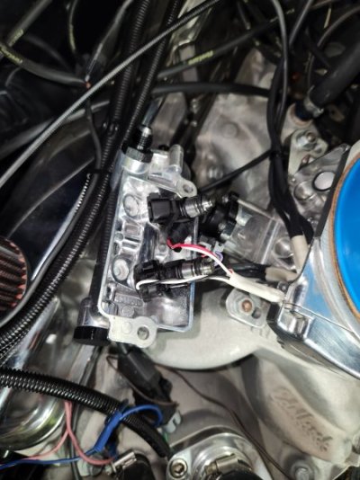

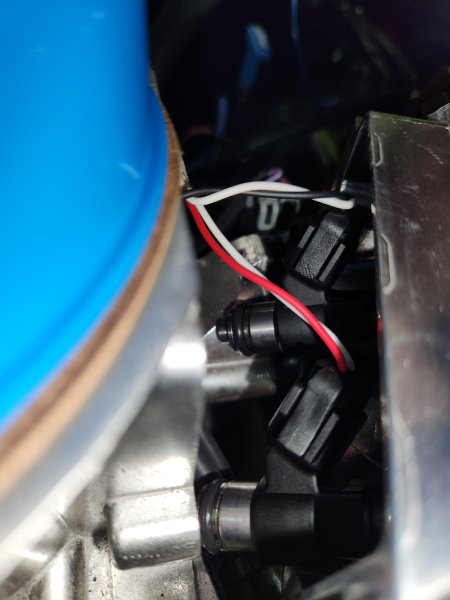

The loose or broken connection is a common problem for the sniper 1. My mileage had dropped to around 9 and the engine was acting like it had a miss under acceleration. My wife spotted the dark area on the throttle body as soon as I took the air cleaner off. I decided to try the sniper 2 instead of going in a potential rabbit hole with the other one.
