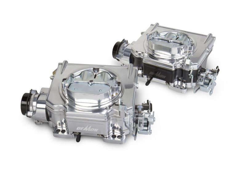

Just put one of these on the 318 truck and like it very much, off idle breakaway is great.
http://www.demoncarbs.com/Types/Street Demon.asp
I saw them a while ago advertised, those do look interesting, never seen or used one personally thou, {Demon is owned by Holley now}, an old Road Demon 525cfm VS {looks allot like an 1850 600cfm Holley} them Street Demon 625cfm look an older 3bbl carb...

Haven't heard anything negative about the Street Demon like you do about the Edelbrock carbs either...Yet anyway
