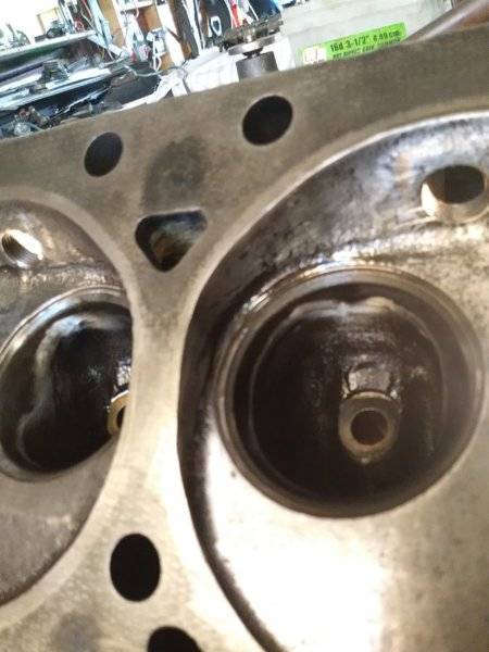

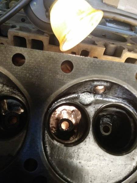

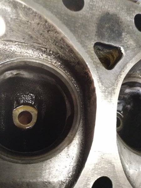

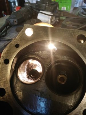

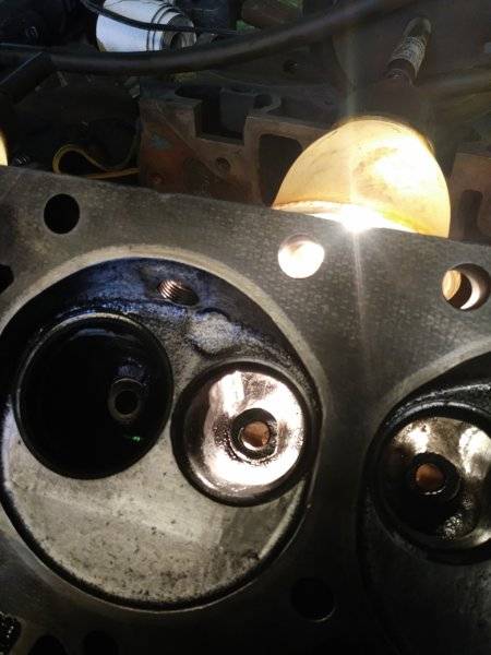

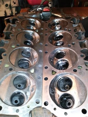

346 heads on a '73 440 @ .030 over. Ported and polished with gasket match. Valves lapped, material removed under the valves.
0531181313.jpg 0531181313a.jpg 0531181314.jpg 0531181314_Burst01.jpg 0531181314a.jpg 0531181314a_Burst01.jpg 0531181314b.jpg 0531181314c.jpg 0531181314d.jpg 0604181352.jpg

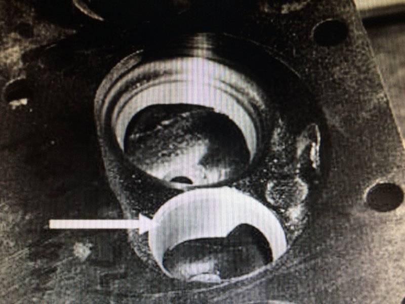

One easy thing is to get rid of the overhang between bowls. Take the straight edge out between cylinders on each bowl.

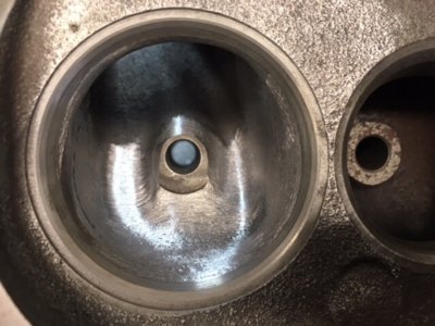

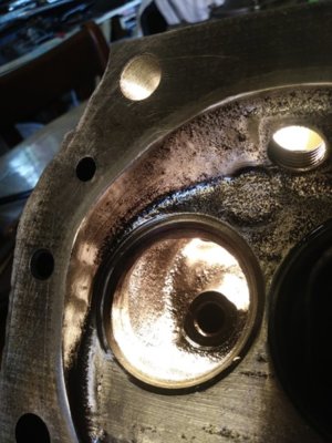

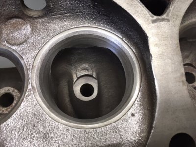

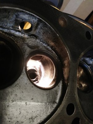

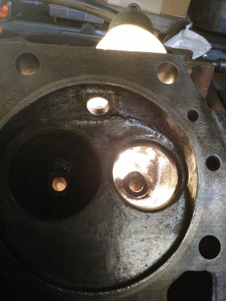

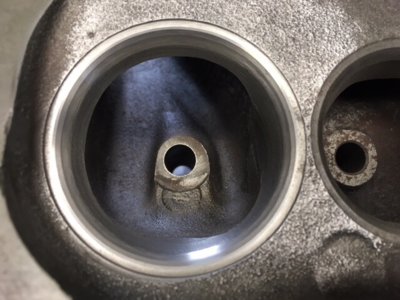

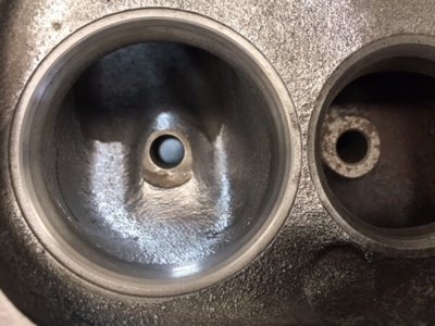

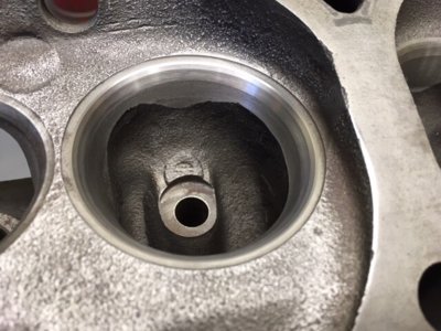

Supposedly, a picture is worth a thousand words........
346 head:
A- stock head, OE valve job
B- grind seat
C- before porting
D- bowl roughed in, bullet nose guide

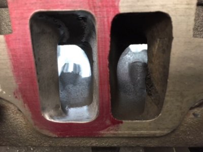

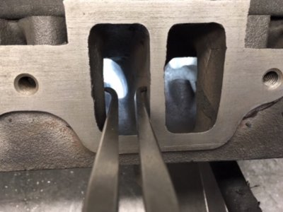

It's really basic removing material along any ridges and directing air flow to smooth the way...you just have to be careful and go slowly.

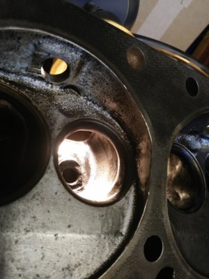

E- quick sanding roll job
F- stock port opening & pushrod pinch(.975”)
G- gasket match, open pinch to 1.060”

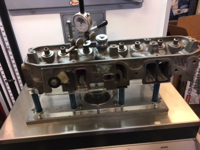

H- testing the work
The stock head will flow about 220.
These tests were done with a back cut OE 2.08 valve.
Test A is with the valve job and blended bowl, test B adds the gasket match and widening of the pinch area.
4.375 bore, 28” test pressure:
