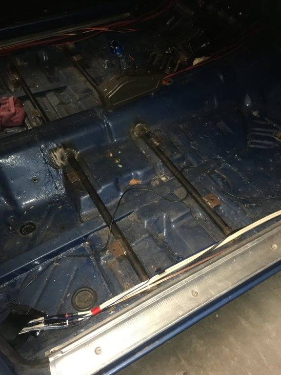

Great opportunity to rid myself of a previous owner's brilliant idea - welded in seat brackets! PM me if interested - first $490 gets em. Custom!

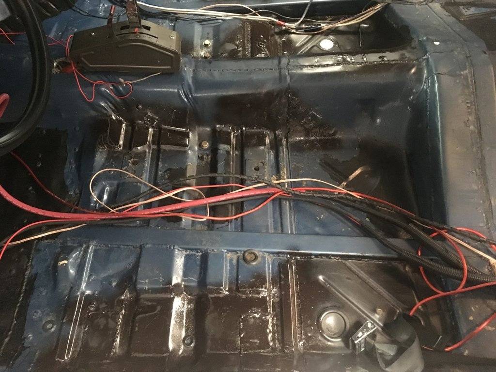

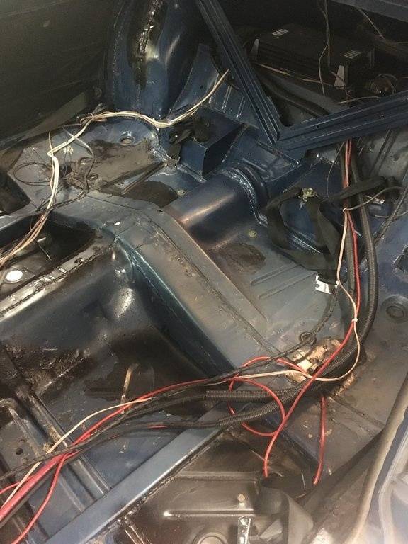

Cleaned up and resprayed the areas that looked suspect, but the floors were solid and rust free.
Don't mind the wires... stereo amp and battery relocate...

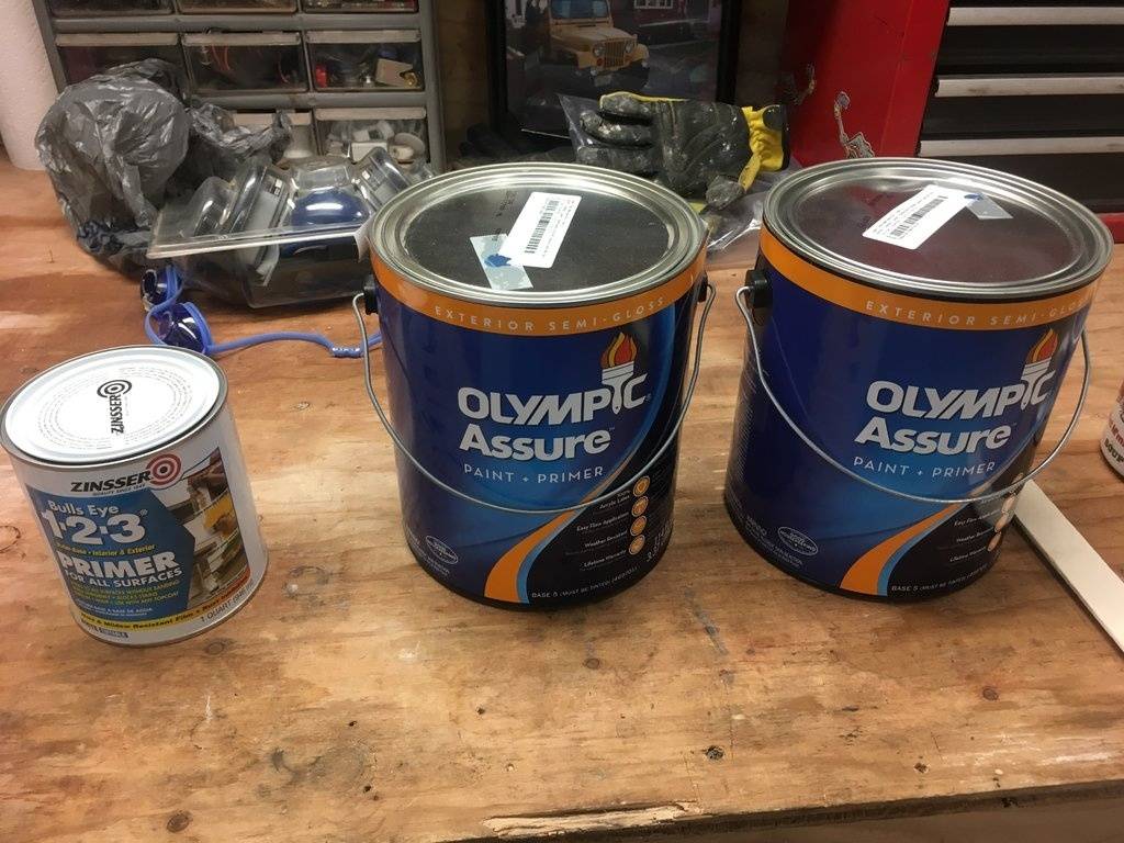

2 gallons plus 2 lbs of beads cost me $70 - bonus: I had the paint color matched in a nice semi gloss. Beads will be in later this week, so stay tuned...

I can't blame you for looking at alternative options, ridiculous what they want for any of these sound deadening products:eek:!! The only thing I'd be concerned with is adhesion. Good luck.
Why latex, why not a decent automotive enamel?? My issue with latex is its not chemical resistant - spill alcohol or gas on it and it acts like paint stripper.

Por15 is awesome - that's the black spots in the pic of my floor pan. You can definitely paint over it.
Yeah, adhesion is a worry. I have some sheetmetal laying around (plan to create a wall between trunk and cabin). Gonna prime and paint it then test out a few coats of my concoction on it before spraying the car.
I'd have thought to go with automotive paint as well (or at least a rhino liner type of material) the Lizard Skin guys say it's an acrylic latex, so that's what I went with. I plan to test it out first either way. If it doesn't work, maybe I'll paint my house to match the car.
View attachment 431051 View attachment 431052
You are going to apply all that water based product to your floor pans? I would be very hesitant to do that. If there are any cracks, unpainted spots (invisible to the naked eye) or gaps near seams or any openings that allow that water based paint to contact raw metal, you are going to start the oxidation process = rust. Think of tiny bubbles in a paint job that occurs over time. That is your sheet metal rusting. If you want to do the lizard skin process, I would go to a solvent based paint that will not cause rust. Might be a little harder to apply and smell more, but you will eliminate a potentially major problem. If you don't want to use a solvent base, then at least use a water-based DTM ( Direct-to-metal), which has rust inhibitors. Just my opinion. For the record, I have been selling paint for 40 years.
