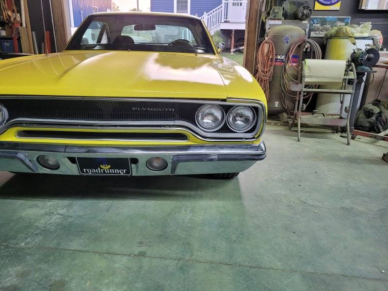

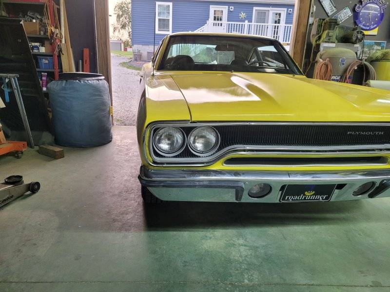

What adjustment am I missing here. Hood and grille won't match up. Fenders and hood original to car, aftermarket grill . Just looks bad on both sides of hood. Any advice ? Thanks in advance
Adjust “up” the front hood bumpers a turn or so(?)
When I di that ,it makes the gap between hood and wider
Makes gap wider between hood and grille
No. I just haven't put it on yet. I'm talking about the area out at the corners of the hood . See the big gap between the grille, makes it look like the grill is sag on the ends
