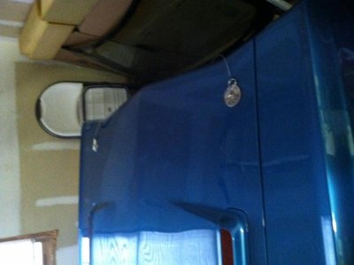

Thanks for link to 'Lift-off' forum. Though it took a while, I finally installed the hood pins. Rather than use the existing inboard radiator support bolt, I chose to use the A12 hole location and drilled the holes. I must have measure a dozen times before drilling the top hood holes! I feel the location closer to the front edge of the hood and looks better. Thanks again. They look great. See photo. hood pins RR.jpg
