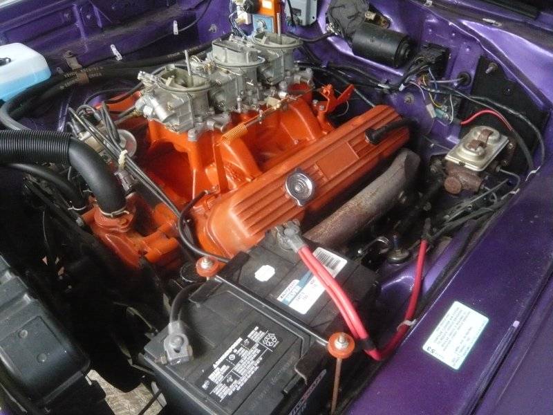

Hood scoop
If you don't have a fan shroud, get one on there - makes a huge difference.
I'm a big fan of fresh air intake, but I think you have another issue ......... have you experimented with timing or anything else?
I've not as of yet. I did check it when I got it out of storage in July, and it was still at 35 degrees total, where it always has been.
