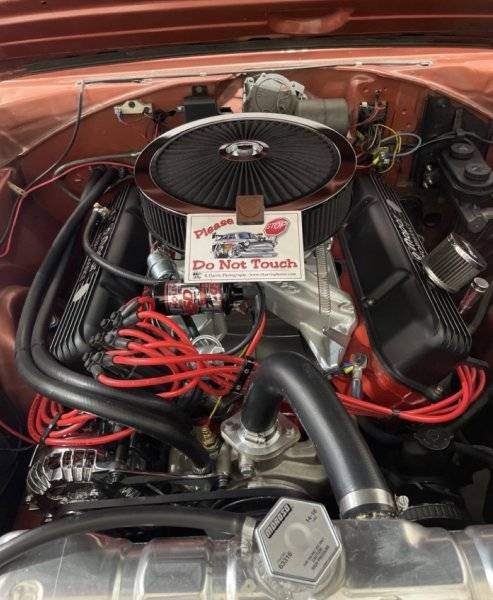

My 1970 Plymouth Satellite needs more fresh air to the engine compartment. I can't justify $2000+cad for a custom fibreglass hood. Below is a picture of the car, along with a close up of the hood, top and underneath. I love the A12 style scoop, but it wasn't used in 1970. I believe the Air Grabber was used. So I need some direction here. If I decide on the A12 or the Air Grabber, it will result in me cutting my hood, and installing the new scoop. What reinforcing will be required to make sure my hood remains structurally sound? The Air Grabber looks smaller, and one of the reasons for doing this mod will be installing a full size 14x3" air filter, instead of the 14x2" I'm running currently. What other factors am I missing on doing this mod? Will an A12 look really out of place on my '70? Thanks all.
It's your car, put whatever scoop you want on it, if you want go that far. I understand your pain for hood clearance.
If it's just some more airflow to the carb that you want, throw one of the ultraflow tops on the air cleaner.
(The sign is for the meat sticks that almost feel a need to treat cars like a petting zoo at cruise nights.)

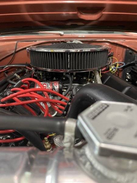

That's 14x3 on a AVS2 with Torker II intake, hood closes fine.

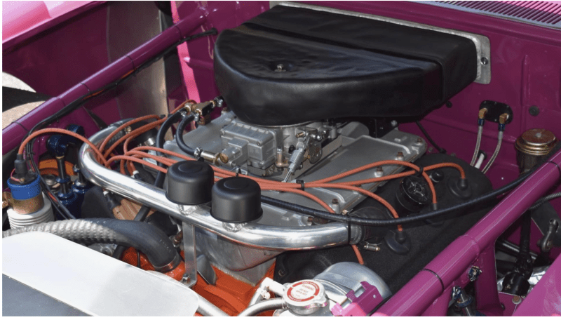

I like sleepers and loath to cut holes that show. I have always liked some version of the W-30 solution or drawing from the cowl, like a Daytona.

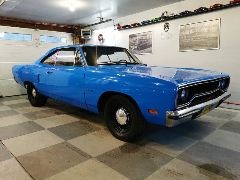

I believe the 70 air grabber was a different hood. It would be a experiment to make it fit on your satellite hood. Suppose it could be done but the air grabber hood is available as a repop...or at least it used to be. your car would look great with this on it. We did the same on our 72 satellite. but it was a bubble w a door that bolted on in 71-72. Possibly a 70 Roadrunner hood would be a simple air grabber upgrade. I think they just cut a hole and have a reinforcement plate on the RR GTX hood? Haven't done a 70 so?

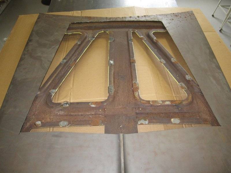

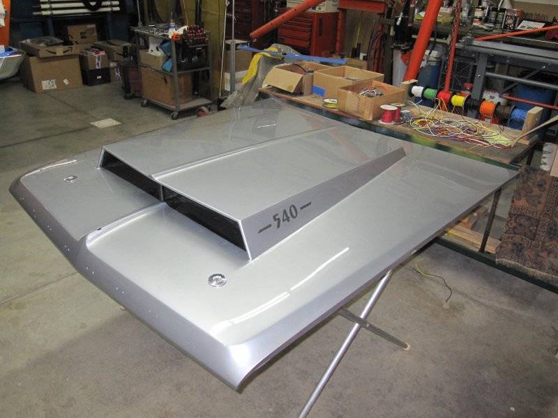

I went with the glass hood and separate scoop for my 66. Now, for the last 25/30 years I have 2 good 66 steel hoods in the rafters? The scoop I made for the 65 is the skin off my original hood (with the structure rotted out) with angles to match the factory angles. I too did not want a scoop but, I wasn't about to starve my 540 with a small air cleaner setup. Note the added reinforcement-not attached to the skin. The scoop is glued on by the way.
Mike
Mike

Yeah the Performer RPM is virtually the same height as the Torker II. Try the Edelbrock heat insulator instead, it is more like 1/3" instead of 1/2". I use the Edelbrock base that comes in the 1221 air cleaner to clear the linkage. Not gonna say I have a ton of clearance, but the carb can gulp more air than if I had a solid cover. Something to consider before butchering up a hood or spending a bunch on another. Can run the ultra flow top with your 2", and the wing nut area is recessed on it too.
**EDIT**: put in a pic from today, that's my current clearance. Like I said, not much, but clears the hood.
