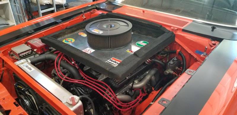

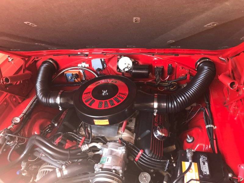

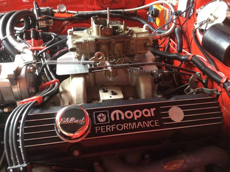

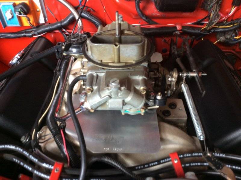

                          7180E8E6-A6CE-4FF9-9FD5-EDDD9578592D.jpeg B99886E2-A58D-441F-B9B8-46267F42C061.jpeg FF0C0DFD-DD34-4C97-9F7A-633112311B8C.jpeg True cowl induction was my theory, cool air, cool fuel, 5 to 8% more air pressure at base of windshield depending on speed. Heat shield and phenolic riser to cut carb temp. Insulate and route fuel line away from motor. Incoming air always below 100 degrees, while engine bay in excess of 200 degrees. All pre dentonation is gone on 93 octane and more timing available. All outside air is now feeding from two four inch inlets to a filtered intake unit. Cool air, cool fuel= more power!

                            I see a G.M. part! SHAME on you!
                            :poke::drinks::rolleyes::D Lol !
