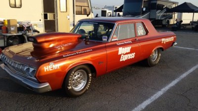

Stock engine that came in the car with an overbore of .060. Stock hood scoop that is not facing backwards, like the Cheevy boys do it. Stock carbs that are jetted right. Just over 3200 pounds with driver and these cars are running 8.40- 9.00. ss/ah

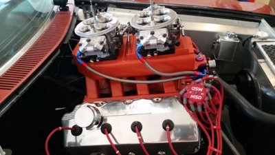

Well, if you are going to put on a HOOD SCOOP, may as well have a REALLY BIG SCOOP....LOL
This induction system actually required this big scoop to clear the aluminum sheet metal tunnel ram with the 2 Dominators mounted on top of the intake....
