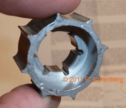

I am curious what it is also. Weird one. Wonder if it is a slant pickup in there?
I believe you need to remove and correctly reinstall the reluctor on the shaft, and yes re-time it. Looking at the first picture in post 27, it shows how the reluctor teeth align with the rotor slot in the shaft. Here is a picture of mine, over 200K miles. Notice the difference, yours appears advanced at least 30 degrees, if not more.
This can also explain what is happening when engaging the vac advance. It's advancing the spark trigger pulse and is firing the previous cylinder, but it's now very retarded.
I also noticed the keeper pin, (small roll pin in the reluctor) is adjacent to the rotor slot, mine are all installed opposite the slot because that is where the grove is machined in the shaft. Maybe the newer ones are different, but this is what really looked odd to me.
This photo is very helpful. I now understand much better what the other guys were getting at regarding a rotor phase problem. I can compare mine to the 440 distributor I've on hand too. Thanks much!
I did have time today to try reversing the two distributor lead wires. No spark, so this one only works one way.
Could definitely be that. See the arrow in the pic make sure the roll pin is in the CCW position, the one in the pic is in the CCW position for b/rb.
