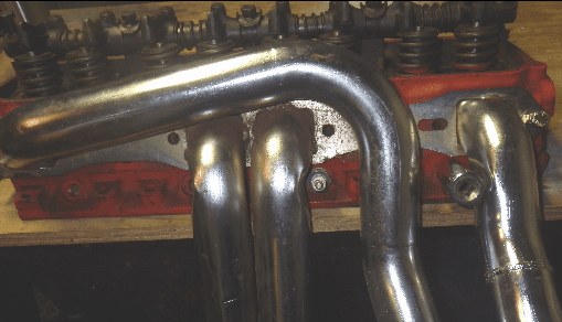

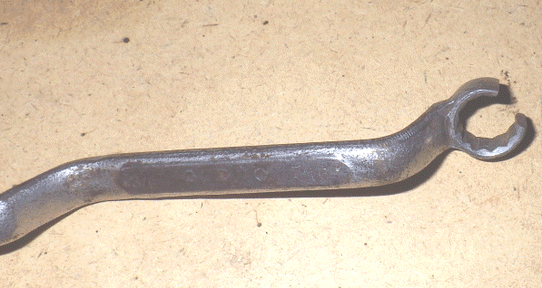

View attachment 1141980 View attachment 1141989
I've got a special lopped off box end wrench for a couple of those "captured" little bastard bolts... :)
Lol, #2, that's the one I start while the header is hanging on a stud further back while I hold the front away from the block with one hand, and preach words of praise as I try to turn the bolt with the other hand. :D Once started, go after the next difficult. Someone with small hands around to help can be a benefit.
Some headers, #1 can be fun too!
That's the little bastard! The 2nd one back...:mad:
