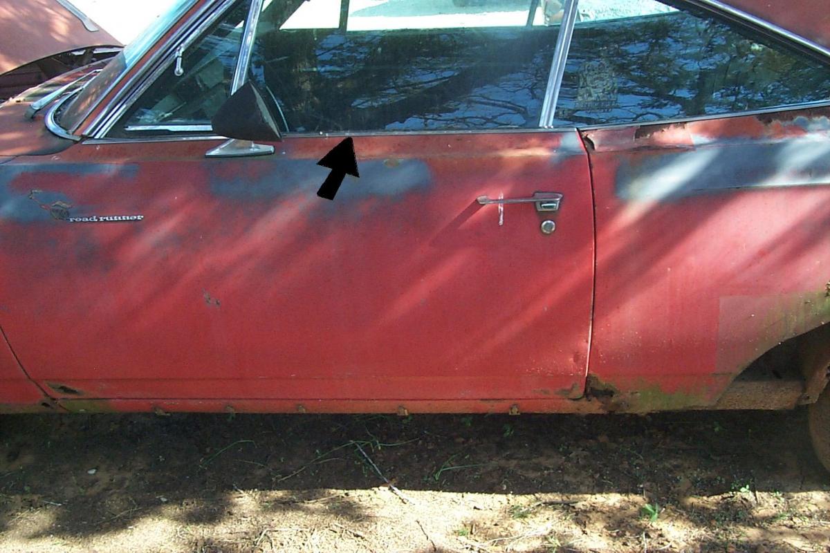

It is the optional moulding that runs along the top of the door and top of the quarter panel to the bottom of the back of the rear side window. Most often seen in conjunction with a vinyl top. In your case it came in the Spring Special package. The Spring Special option is also seldom seen on these cars as most people were interested in keeping the cost down on their perfromance car. That was the reason the RR was created. Most that wanted a "fancier" car (and could afford the extra insurance) bought the GTX.
Moulding

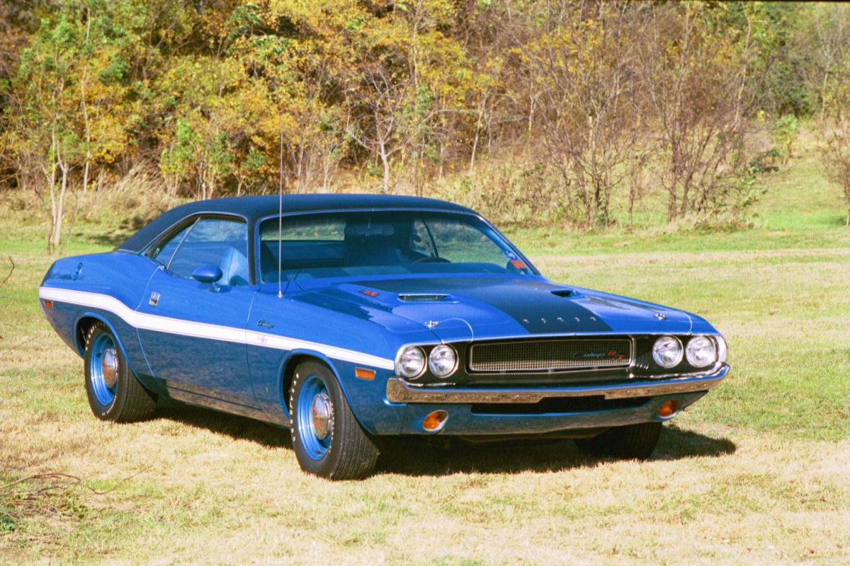

This is the best pic I have that shows it I think. I would assume the window moulding is what you are talking about? Thanks again for the great help.
Nope. It is on the SIDE of the car and kind of "frames" the bottom of the side glass but is attached to the top of the door and quarter panel under the rear SIDE glass.
Body belt moulding are the mouldings at the belt line of the car which would be on the side,center of the fenders,doors,snd quarters.This is basically a moulding to keep the shopping cart dents down.It is a harder to find option and most people take them off when they redo a car.But a body belt moulding and the stripe? I suppose its possible I have seen odder things on Mopars.

It would be unlikely that the moulding is missing.
Look on the outside of the top of the door. It is a shiney moulding about 1/2" wide that will run along the top of the door skin. It butts up to the very small shiney trim piece that the window felt (cat whiskers) are attached to that the window glass slides against.

That car I pictured doesn't have the A-14 package. No vinyl top. But it does have rocker moldings and fender mounted turn signals.
