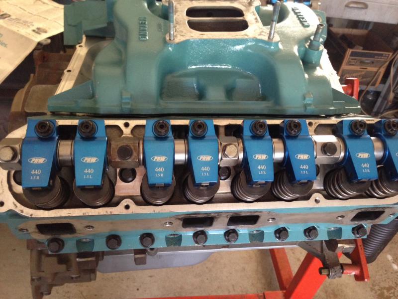

-Existing CAM is in GREAT" shape!
-Lifters are like brand ne as is CAM
-RPM range: 1,600 to 5,800
-CAM is a Comp Cam XE268H 21-223-4 280 224 230 @.477
-Torque convertor that came in the trans was a 12" with balance weights
-Flex Plate seems to be for the "Internal Balanced" engine, this is a cast crank engine with external balance
I am ordering a Hughes 11" torque Convertor with a 2,500 RPM Stall
(I was going to go with a 2,000 RPM stall but I think the 2,500 RPM stall would be better suited for the 67 GTX w/ a lightly modified 440)
