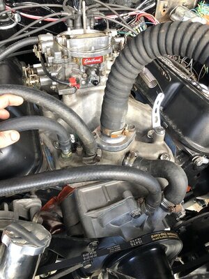

Just seeing where the hose on the left should be going? Didn’t have any hoses when I got it. Not even sure one is suppose to be there. Temperature sensor is to the right of it. La small box 360
Edit...Nope....
I take it it is the extra big hose in your hand. Is it to the pcv valve? Front, large vacuum port on carb?
You have the heater hoses, by-pass, and the temp sensor, so that can just be plugged with a pipe plug. Aftermarket intakes usually have a lot of openings for different sensors, but is not needed in your case. The plug should be 3/8"NPT.
It’s an aftermarket intake. The extra hole is for a mechanical temp gauge. Factory small block intakes don’t have a spot for a mechanical gauge.
