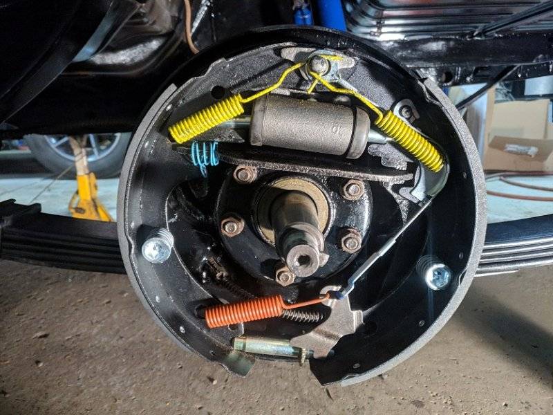

Installing Strange S-60 rear end.

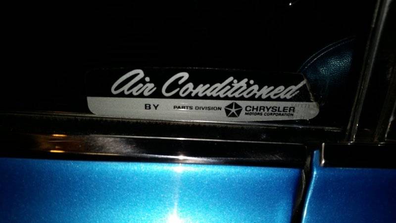

Saw one of these on a 69 Road Runner back in day, and wondered why it didn’t have the “air temp” logo. Learn something new every day, 50 years later…

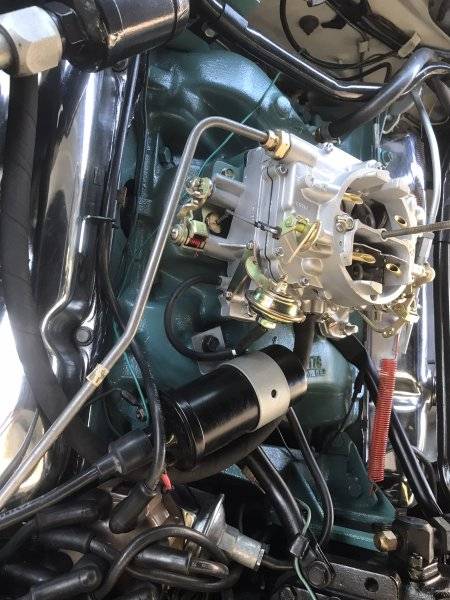

My 70 looks pretty factory under the hood but not so much under the dash. The system still has R12 in it and will freeze you out!

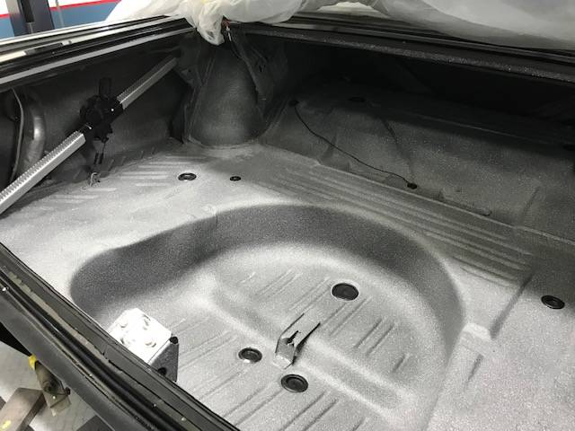

66 trunk - car was previously media blasted (PO) so I’m not sure where it fell in the transition from zonolite spatter painted trunks to body colored trunks in 66, so I just freshioned up what was there.

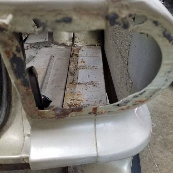

New AMD mini tubs in progress by ns1rm21
The small angled piece is an example of the stretched and shrunk piece that was made to add a flange back onto the trunk pan. The trunk pan is stamped with a flange that gets removed when the trunk pan is narrowed. The flange is what the tub is spot welded to.
