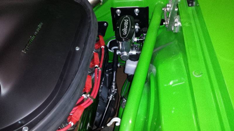

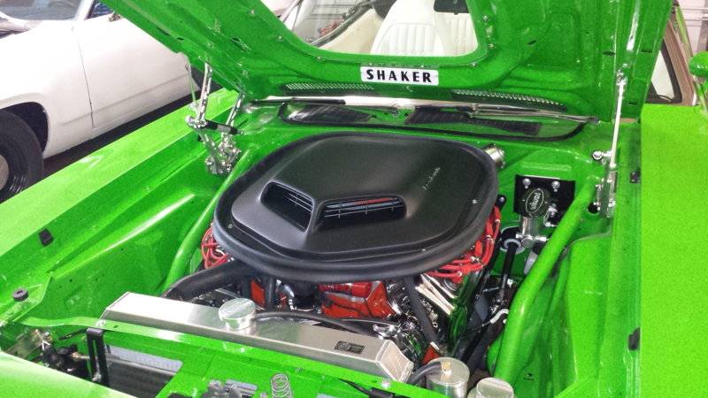

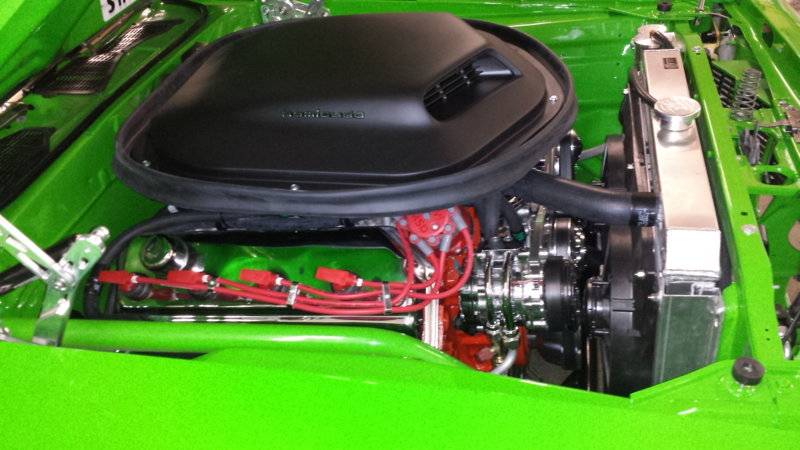

Here is 71 Cuda resto-mod that I did for a customer,
Having a big o fat Hemi helped to hide everything.
I ran the front body wiring under the drivers fender and the motor harness through the firewall right behind the motor. Controllers went under the dash. I made all the harnesses.
A/C lines I ran down along the frame rails.
Heater lines across the top of the intake manifold.
Has Fast EFI and ran the fuel lines up the backside of the motor.

That's some excellent work right there, great job!!!
747mopar tell me about this cool.scoop and hood , I would like to do something similar

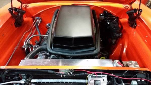

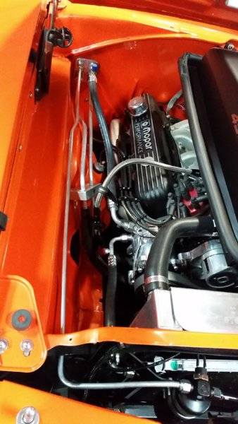

Nothing mounted anywhere on the firewall or inner fenders but master cylinder. I filled all the factory holes. Everything needed is mounted to my front plate and wiring hidden as best as possible.
did you still run the headlights/turn signals across the radiator support?
great stuff; just bought a couple things due to the inspiration.
I would have tidied up the fuel lines a bit instead of leaving them hanging in mid air and that upper rad hose is just hideous. A little project for you in days to come. Just MHO.

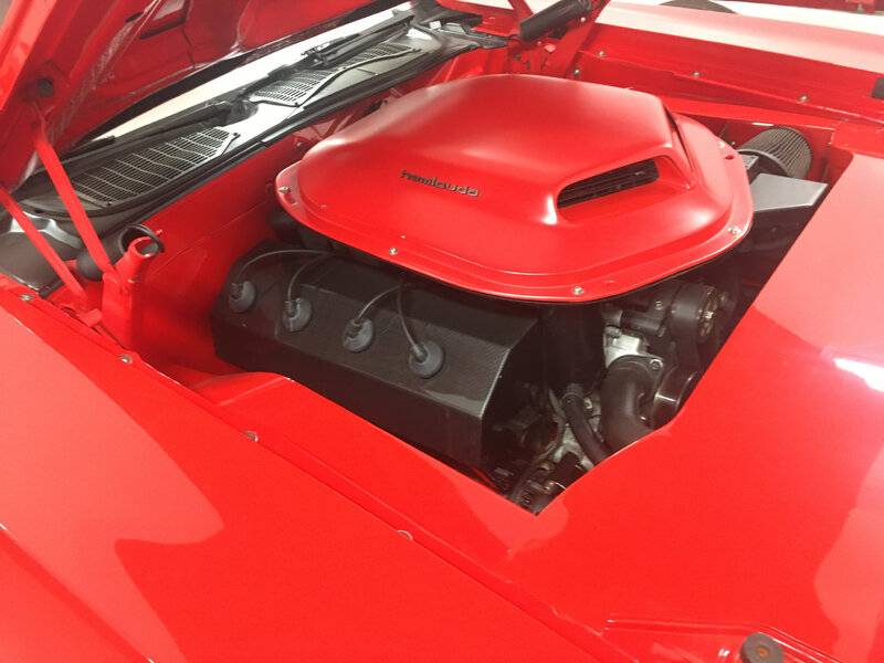

1970 Cuda conv't ,6.1 stroked to 426, twin screw supercharger, 6 speed viper. All fab out of alu, including the Hemi style valve covers to cover the coil packs, and a lot more. As stated before depends how much work u want to do. Good luck and have fun. I did and still do
