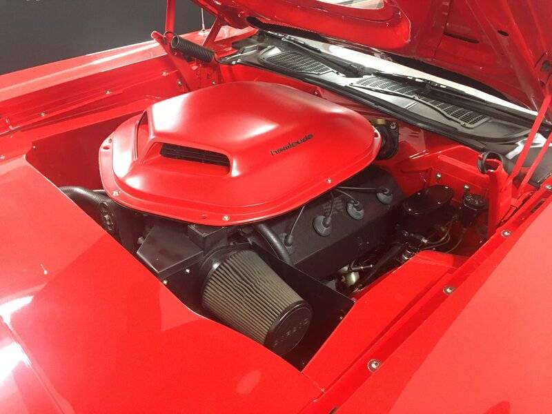

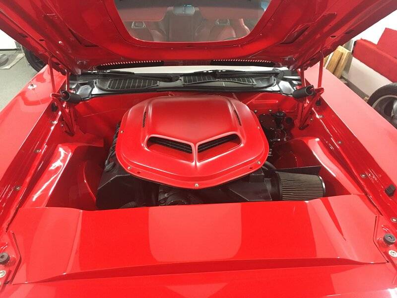

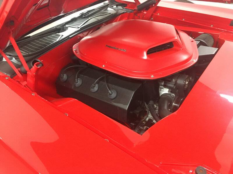

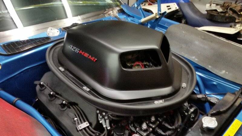

1970 Cuda conv't ,6.1 stroked to 426, twin screw supercharger, 6 speed viper. All fab out of alu, including the Hemi style valve covers to cover the coil packs, and a lot more. As stated before depends how much work u want to do. Good luck and have fun. I did and still do
Awe, such a cute little Shaker. I like it. I custom made one for mine also.

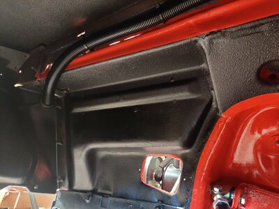

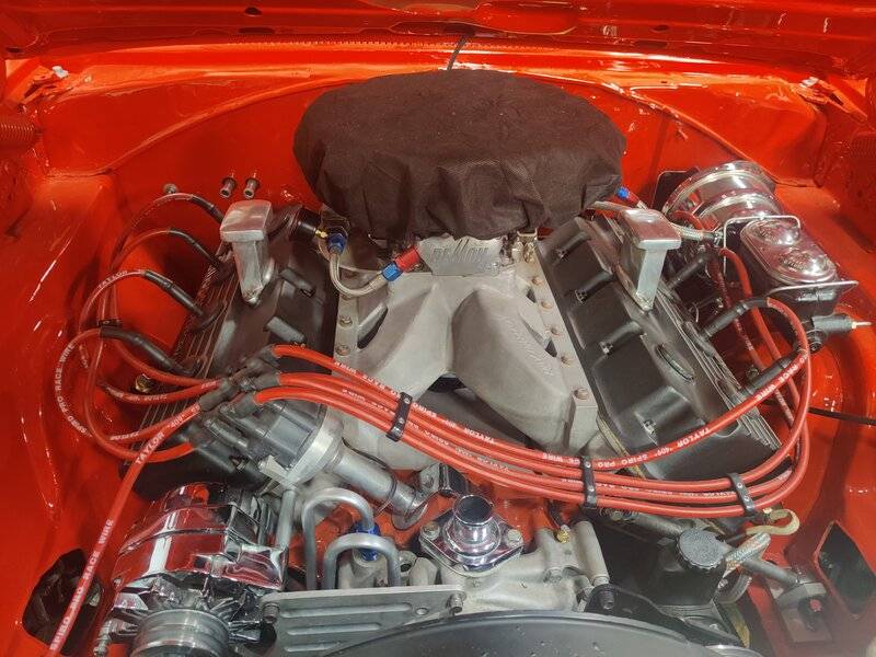

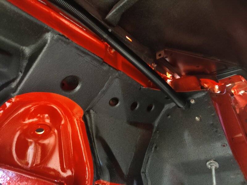

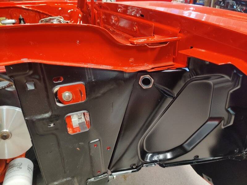

Routed all wires in the wheel wells through industrial grade robotic hoses.

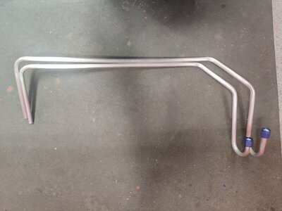

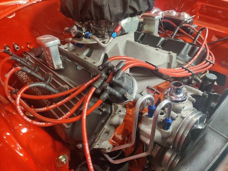

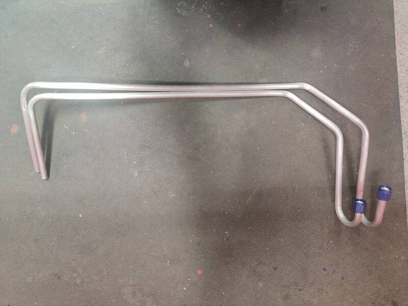

The ugly heater core hoses are replaced with tubes and AN-connectors. Routed it between the engine and headers. Tight fit but doable.
