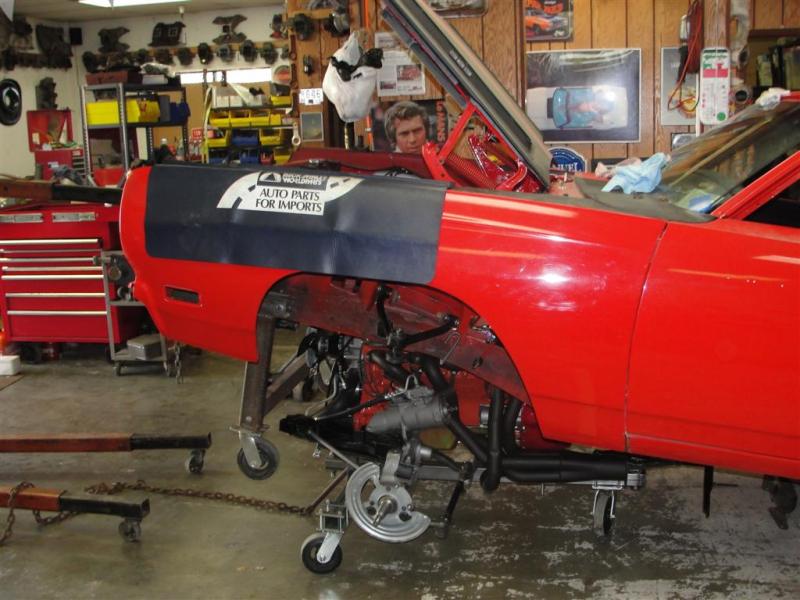

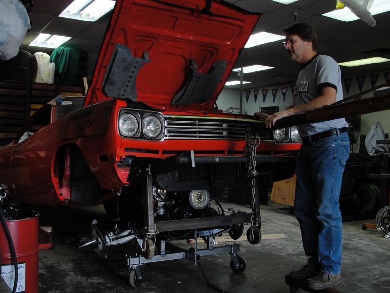

The best way to put them in all bolted together would be to mount the engine on the k frame and lower the car down over the drivetrain like the factory built them. This can be a pita if you dont have a lift though.

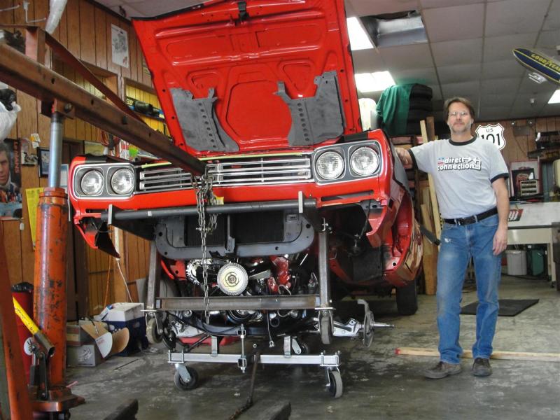

From the bottom is the only way to go, especially with a tight engine compartment that has headers.
In my opinion, the pain it will be to lift the front of the car and get the K-Member under it will be WAY LESS than the PITA it will be to get all the parts fit in AND have your nicely painted engine bay survive unscathed. When installing from the bottom of the car, you can assemble everything out of the car: engine, headers, trans, linkage, starter, all engine accessories, etc.
