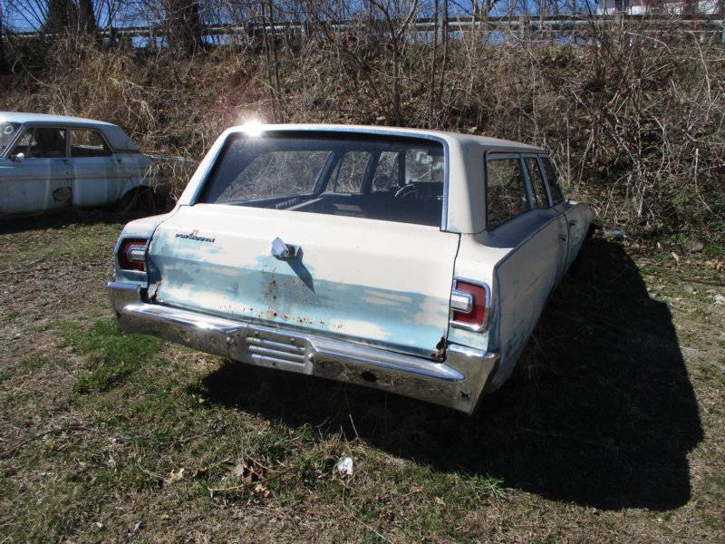

Have a 68 Satellite station wagon that I just rolled the back window down manually and now I can't get the window back up. so I figured it needs lubed up and trying to get the tailgate open but cant to take off the panel to get to the window mechanism gears and rollers.
There is a lever on the inside of the door that says Gate and Door. Does that have anything to do with it or maybe the door is locked and need to put key in it and unlock it.
