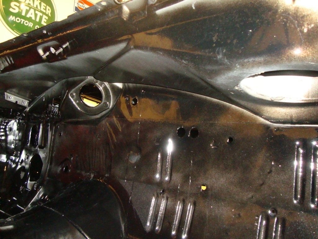

justin i notice in one pic of gtx there are three holes at front inside floor board and cowl,do you recall what those holes are for? see pics below. thanks
justin i notice in one pic of gtx there are three holes at front inside floor board and cowl,do you recall what those holes are for? see pics below. thanksView attachment 404324
Which holes do you mean? The small holes in the firewall are for the plastic nails that hold the insulation. The 3 medium size holes are for the studs on your heater box. The 2 larger holes are for your heater core....
