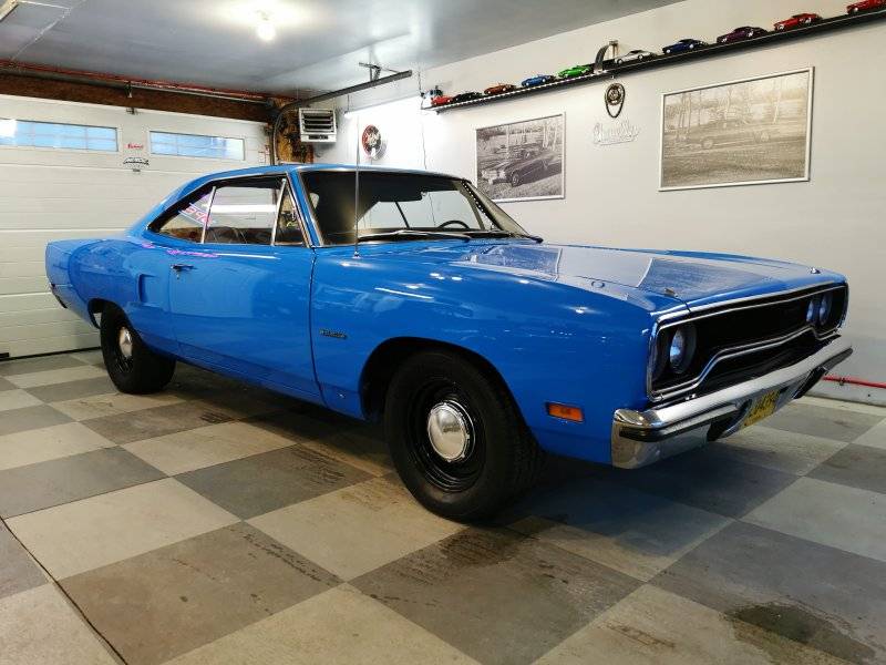

My current setup has me rolling down the highway at 2900rpm. That's 60 miles/hour, or 100kms/hour here in the land of metric. This may be a dumb question, but how much harder would it be on the engine/driveline going 2900rpm for long distances, like 2-3 hours at a time, as opposed to lower rpm driving in city, or having higher ratio gears and a little taller tire? I run 3.55's, with a 255/60-15 tire. I would have loved 3.23's, but I couldn't pass up the deal on the rear end. It's an 8 1/4" with a Yukon Dura Grip. Now my wife and I seem to be doing more cruising at highway speeds, and I'm wondering if there's anything I should be keeping a closer eye on because of the rpm? For the record, this is my '70 Satellite two door with a 440/727. About 475hp at the crank. I also find it cool that I'm still getting 14mpg on the highway. I think that's pretty good.(based on a US gallon. 16.5mpg Imperial). Thanks all.
