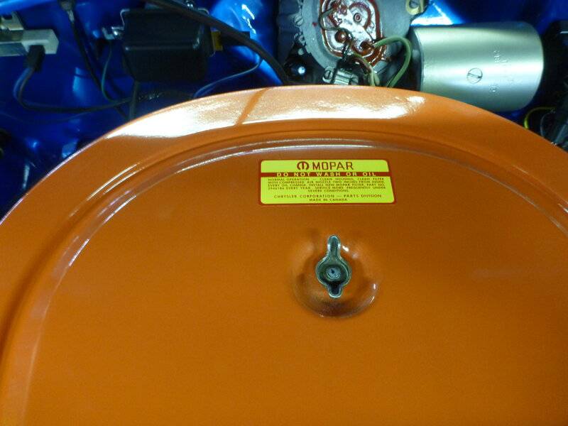

What I was advised is correct.. who knows..

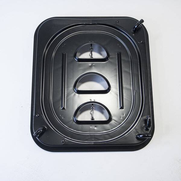

The air cleaner base and lid is not A12. They were not chrome and yours had the wrong perimeter lip(45 degree) required for fresh air hoods (scoop) example A12 and AAR
To OP, the air cleaner in your pic is NOT an A12. The A12 base looks like the one in post#11. It had a rubber bulge gasket on the top of the perimeter. The wing nuts on mine were like the ones in post#7. The lid was orange, not chrome.

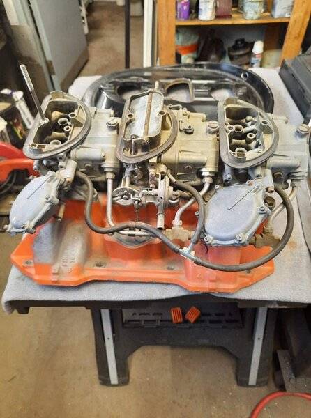

I have a bunch of pictures but I think these are the important ones. Google still says its a A12. I don't see anything that would resemble a date code. What do you guys think?
I can answer your question if you simply take a pic of the intake.
If you want to know about the carbs...post pics the numbers for A12 are 4391(4sp) 4392(auto) outboards are 4393 and 4394 next would be dates (first three digits are days of the year) last is year. example 1209 is 120th day 69
The bolts that are shown, carb to intake are correct "H"ighland bolts.
Thank you, we posted at the same time. I think its an automatic because of the idle up solenoid? And the carb number says so
