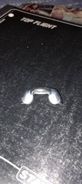

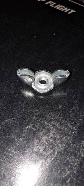

Here is a picture of the reproduction wing nut that everyone is selling, it comes from AMK Fasteners. I will have to take one off of my cars for a picture of an original one, but the originals are slightly different in that the reproductions have a slight bit more of a radius on "wings" where it sweeps up from the base. The details that drives people to insanity.

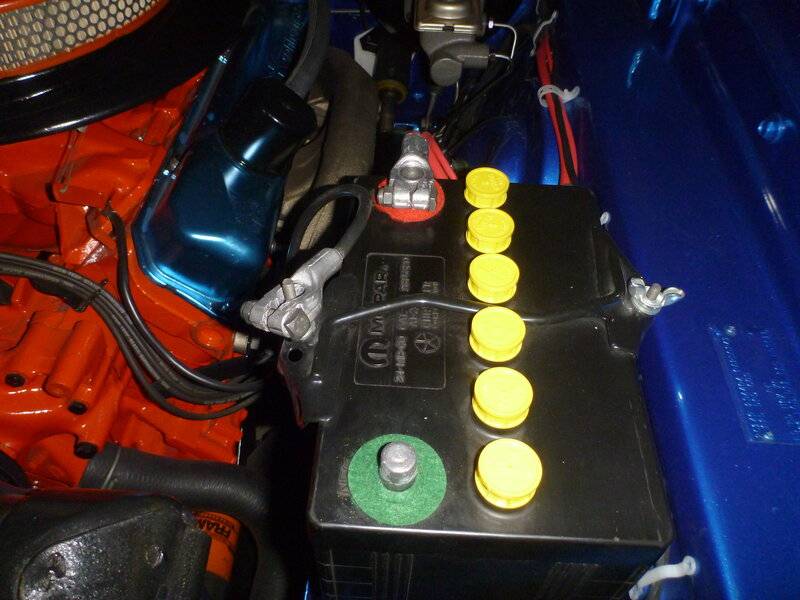

The same wing nut was used on the battery tray J-Bolts with the washer up through 1969 and they changed over to the captive washer and nut for 1970.
I have never seen a washer used on a "fresh air" equipped air cleaner, but our 69 Charger RT has the original washer and wing nut in tact for the "unsilenced breather assembly."
The two barrel carbs used a lighter weight 1/4x20 stamped steel piece while the four barrel carbs used the heavier nut as pictured below. GM also used an almost identical piece that was even heavier, but virtually the same in appearance other than the Mopar piece was zinc plated.

Mine.. Repos on the battery, OE's on the filter.

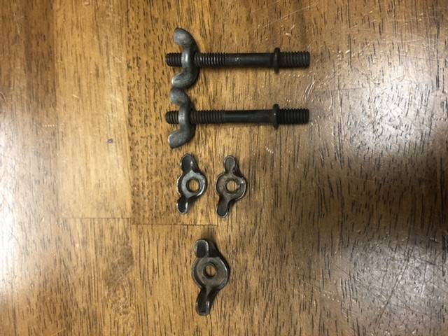

Here’s what I have. The first picture is my 70 AAR wing nuts In the middle The ones on the studs are my original 70 440 6 pack on my bird. The big one on the bottom is either a 4 barrel or a 69 six pack from my A12.
