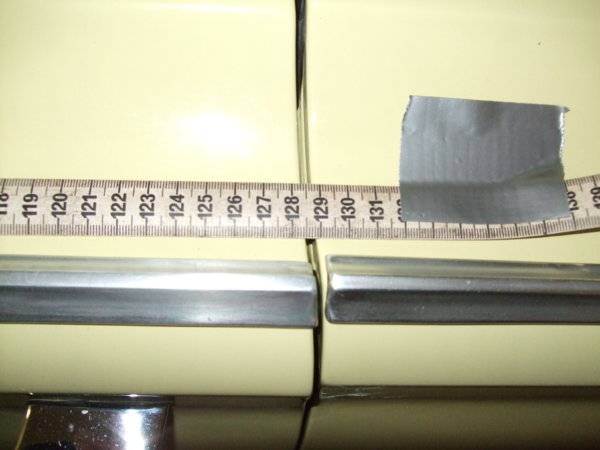

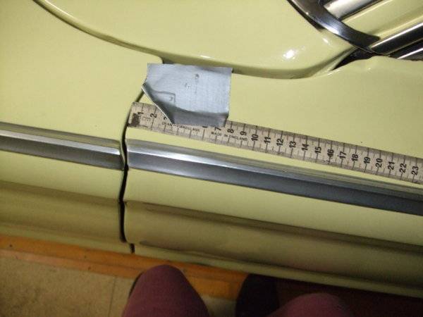

This is from original 2 dr ht if it helps. Should be 50,1/2", or 1282,7 mm.
I have a '66 Belvedere I that I can measure for you later on today. I will post my findings later on tonight.
I got 50 1/4" along the top of the door where the chrome trim is in the picture above from lynchroad. Hope that helps.
