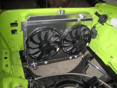

I installed a champion rad on all My cars and overheating was no longer an issue....two 1 inch rows minimum...I extended My Bee from 22 to 26....and it was easy...champion rads are the best bang for the buck as far as I'm concerned

To fit the 26" it looks like I need to do some car body mods under the hood to mount it, right?
So 3 row instead of 4 row should be good?
I went from 22 to 26 on two mopars and it was easy and the champion trans lines lined right up...did have to switch to different size line connectors though
Ok, so no mods requiring metal cutting on the front of the car? Looking under the hood I wasn't sure. Just unbolt the 22", undo the hoses, and mount the 26" in?
all's I did was remove old rad and bolts(hoses also...lol)and mounted it on the drivers side mounts...leveled it, marked the passenger side holes per the rad, drilled,mounted. Even the stock shroud lined up perfect
What metal would need to be cut? Worst case would be drill four holes.
no metal cut....just hole drilling
