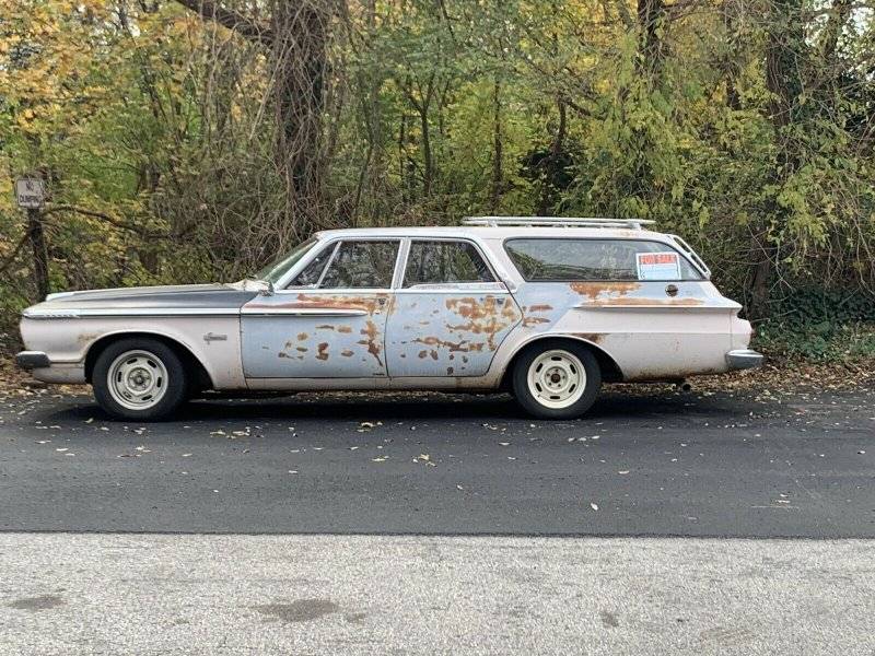

I've got a 62 Plymouth Fury wagon. Plan on doing a color change (white to Burgundy/ with white roof). Trying to figure out the amount of material I will need. I will be painting the engine bay, all five door jambs and lower body Burgundy...and the roof Ermine white. This is not a show car just a nice old driver. The car will be painted with Basecoat / clearcoat.
