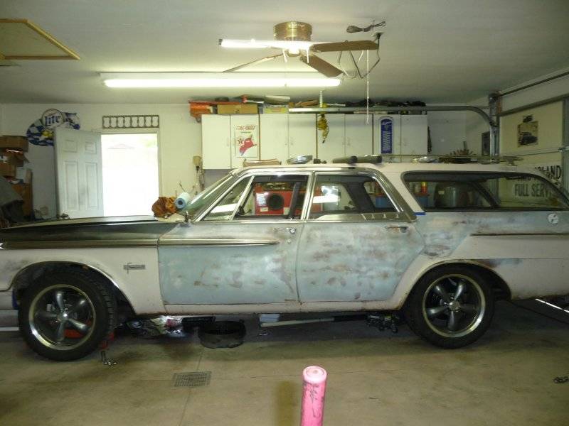

PS, don't try to change my mind to not do a color change.View attachment 1483105
Just noticed your garage floor looks just like mine with the drain in the middle. I get a lot of cold outside air coming in in the winter. My garage is heated so I gorilla tape over the drain in the winter. Idea you may have not thought of if yours goes to daylight. Nice SW. What engine?
It's got a 318 poly, thanks for the drain idea.

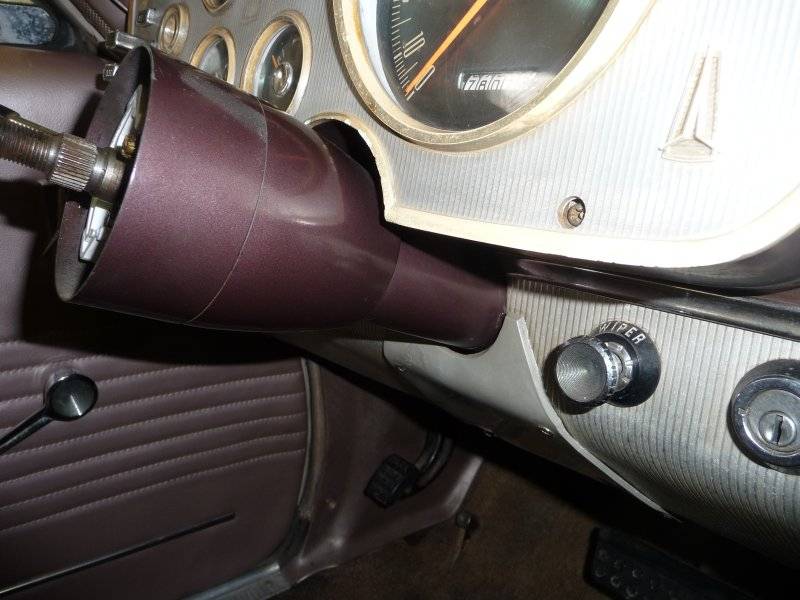

yes, it is a metallic paint color. Never knew about NO wet sanding metallic sihgle stage..thanks for the tip. Cordovan is the color of the steering column. (it's a 1962 factory color for Plymouth)
