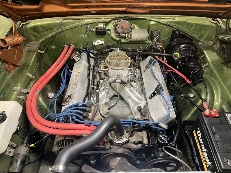

Hello all. So like the title says, how much carb is too much carb? It got me wondering if i have too big of a carb or i got something else going on.
I have a 69 sport satellite wagon. I pulled a 383/727 out of a 68 fury. It has a freshened upper end, but stock bottom end. I have an edlebrock torker intake and a rebuilt holley 4 barrel, single pumper carb. (3310-3 series, electric choke, vacuum secondary). I have gone through and verified that the points are set correctly (gapped and cleaned) and that the timing is set to 10 degrees (as per factory, for now). I have 12-13 inches of vacuum, i have size 74 jets in the carb with a 6.5 power valve, dont recall the squirters size, but i think they are a 38? I am running right close to 13.7 /13.9 air fuel ratio (as with a AF meter on the tail pipes, a little rich i know). I am at 6450ft of elevation (Rocky Mountains).
I know that mopars love a bit more advancement in the distributor, but i am still getting popping and back firing through the carb (probably ruined that power valve by now) but i have little to no throttle response at low speeds and then it occasionally stalls out. I cant even power brake the car without it stalling.
Which made me think that maybe, the carb is too much. If I remember, the 383s came with a 600 or 650 from the factory, at least for the ones who didnt have a 2 barrel.
Id love some input. Thanks.

Your carb isn’t too big. Maybe a vacuum leak? Does the idle go pull-up & down? I suggest you put that carburetor back stock and adjust/modify from there as needed & I agree you need to advance your timing
Ir could be a cam timing problem.
I agree. Retarded cam timing or ignition timing. After getting the carb mix screws set correct and i like to do it with a vac gauge. Turn them out 1/8 turn each til you get max vacuum in drive. I would start with the mix screws at 1.5 turns out. Make sure the pumps are set to immediately squirt as soon as you open the blades. After setting carb correctly, you still have same problem, look at the ignition timing and then the cam timing. I am assuming there are no vacuum leaks.
