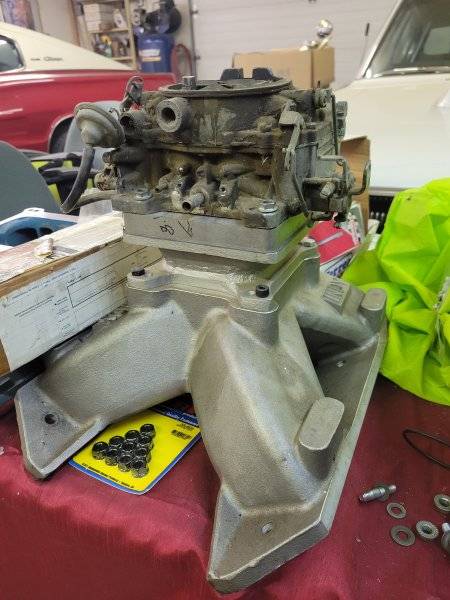

Hello all. So like the title says, how much carb is too much carb? It got me wondering if i have too big of a carb or i got something else going on.
I have a 69 sport satellite wagon. I pulled a 383/727 out of a 68 fury. It has a freshened upper end, but stock bottom end. I have an edlebrock torker intake and a rebuilt holley 4 barrel, single pumper carb. (3310-3 series, electric choke, vacuum secondary). I have gone through and verified that the points are set correctly (gapped and cleaned) and that the timing is set to 10 degrees (as per factory, for now). I have 12-13 inches of vacuum, i have size 74 jets in the carb with a 6.5 power valve, dont recall the squirters size, but i think they are a 38? I am running right close to 13.7 /13.9 air fuel ratio (as with a AF meter on the tail pipes, a little rich i know). I am at 6450ft of elevation (Rocky Mountains).
I know that mopars love a bit more advancement in the distributor, but i am still getting popping and back firing through the carb (probably ruined that power valve by now) but i have little to no throttle response at low speeds and then it occasionally stalls out. I cant even power brake the car without it stalling.
Which made me think that maybe, the carb is too much. If I remember, the 383s came with a 600 or 650 from the factory, at least for the ones who didnt have a 2 barrel.
Id love some input. Thanks.

height wise, its about 2" taller than the stock intake/carb with a spacer. however, i should still have some response.

Single Plane Intake Manifold
i understand that its a heavy car and the motor, at best was 335 crank horsepower. i understand that i wont be spinning the tires and lifting the front end, but i should be able to get up to speed without holding up the rest of the town or stalling out.
First, I'd recommend a different dual-plane intake, that manifold does not belong on your stock application. Second, the Holley 3310 is a great carb, a very versatile piece we'd install on many various engines, it's fine if the systems working as designed.
the gentleman i purchased this intake from ran it on his 383 in his roadrunner and he ran it for years trouble free. couldnt tell you if it was stock or not, but i figured for 50 bucks and no problems with it, seemed like a good gamble. and the carb is the carb i chose because of how versatile it is.

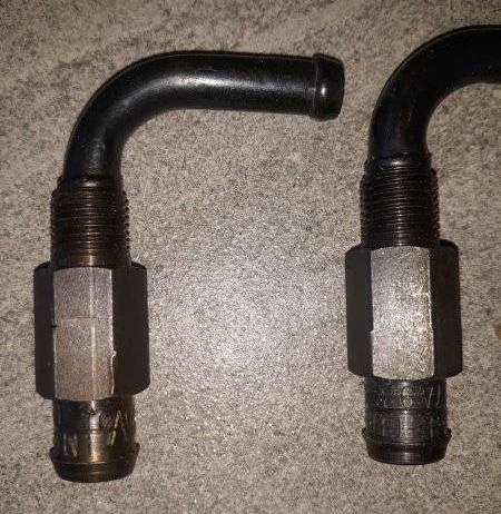

It looks like your engine does not have a PCV valve. That would make it run richer than normal, and a few other things.
no pcv valve, but i do have a breather on the passenger side. if i could find the parts to install a breather on my driver side i would, however i cannot find the mickey thompson valve cover baffles for it. i havent resorted to making one quite yet, but i think thats what im going to have to do.

A PCV valve will make the engine run so much better. This is what the PCV valve looks like.
I will check into this. i know pcvs help, i just have a basic straight through breather on mine, i wasnt wanting to blow out gaskets and seals. ideally id like to install a second one on the driver side, but the valve covers didnt come with that and id have to special make some splash covers for it.

i was not aware of that that they came with such a large carb. but yes, a good sealing engine does make a world of difference.
Vacuum reading's too low. I'm going with vacuum leak.
no vacuum leaks, just an older engine at higher altitude. this has been mentioned above.
So this might sound crazy but I used a vacuum gauge to set my initial timing at the max amount of vacuum and it’s worked great for me. As far as the torker intake goes I ran the torker II for over 30 yrs and had lots of similar problems with a 750 double pumper. Just recently switch to the performer RPM and an AVS 800 and it’s brought new life to my Ride tons of low end torque. I’m pretty sure the specs on that torker are in the higher rpm range. Just my 2 cents.
yeah, i will check into this. id honestly be happy if i could just take off without having to feather it and not take forever to move. i know the car is heavy, and that plays a lot into it. i will check into a different manifold but for now would like to try to make this work.
You should check the valley pan for damage with all that backfiring and popping going on.
