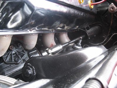

when you were moving the steering shaft, was the box shaft moving or not? Maybe the coupler is worn out?
Must define where the slop comes from before anything

The play is in the box... I can grab the steering shaft and rotate it about 30 deg in either direction and the coupler and worm shaft rotate as well but no movement translates to the pitman arm, it stays still.

No luck...it improved slightly but still tons of play... went from 30 Degrees of rotation (60 total) to 20 degrees. Looks like time for a new or rebuilt box... I did see that Borgenson is offering an ought right remanufactured unit (no core) for $389. Firm Feel and Steer and Gear will rebuild yours for $300 + $200 core. I might just go the borgenson route and save my old core.
