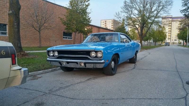

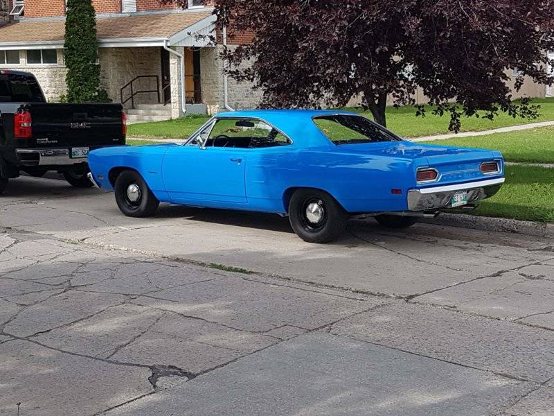

What car body are you going into?

1970 Plymouth Satellite.

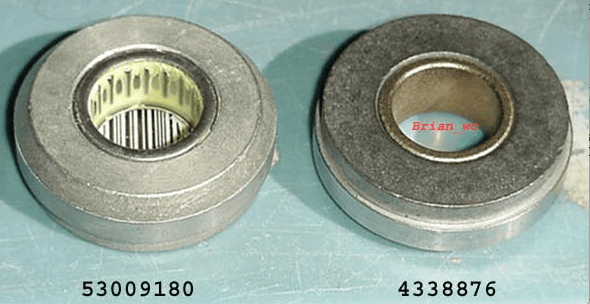

Rather then going with all the factory clutch linkage I think I would buy a hydraulic slave and master cylinder kit with the pedal. Buy a repopped hump. 383 with a forged crank should be drilled for a pilot shaft bushing...unless it's a late 383 w a cast crank then not sure. If you have the engine just look at the crank and you will be able to tell. If I was starting fresh I would look at anything new...tko or anything that fits? You may get lucky and find a good 833 used but a lot of them have been abused. A rebuilt 833 is most of the way to a 5 speed...imo. I 've never heard anyone complain about having a overdrive.
They may exist but have yet to find a cast crank 383. Dont count on the forged crank being drilled for a 4 spd unless it came that way from mopar.
The rest of the post maybe worth looking into.
The car hobby is all about making a car the way you want it. Gather all the parts you need before you tearing into it.
I have a 71 383hp born with a cast crank....I didn't know they existed either until I took it apart. Also have 3 383's 66,68,69 and a 361 all all were auto's...and have a place for pilot shaft bushing..but I am not saying I know all and you may be right...because you never know what mopar did...until you look.
That was the only year I know of with a cast crank and have yet to see one. Yes the BB and RB auto crank looks like it has a place for the pilot shaft and bushing. Putting one there without some machining will not happen and waiting till the build is done to checking it is just a tad late. That was a lesson learnt many years ago.
When I dropped a four speed behind my 440 auto about forty years ago, it was no problem. Back then you could buy undersized bushings that fit the holes in automatic cranks and it worked out just fine for me.
I'd drill the crank if you can, with engine not in the car. There may be a reason not to but either way works. Cutting the nose of trans just runs against my grain.
