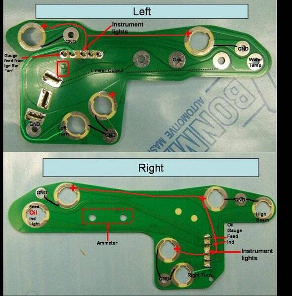

1. Get the factory wiring diagram.
2. Obtain a source of 12VDC (I always just use the car battery, using small jumper wires).
3. You have a voltmeter with a setting to test continuity, yes?
The rest should be fairly self-explanatory.
I always test each bulb individually, once I know all the bulbs work I think follow the 2 sides of the bulbs and one side is 12V and the other is grd, apply 12V and they should come on.

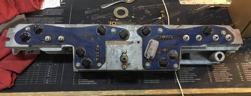

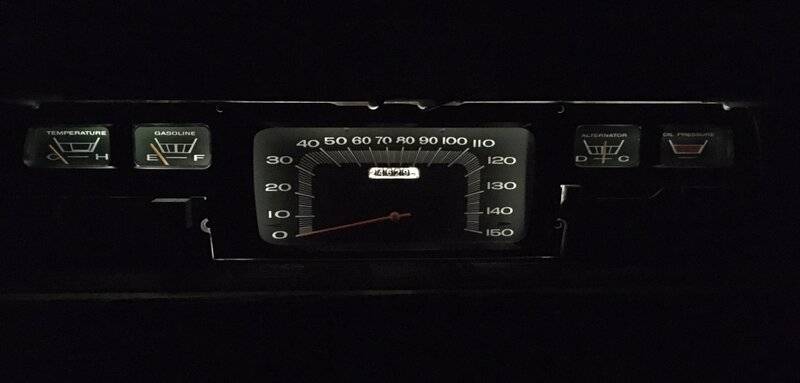

Thanks for the help guys! Success!!
The circuit boards were very corroded. I cleaned them up with steel wool. I also replaced all the lamp "sockets" and bulbs. It worked out well.
