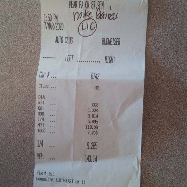

Mike Gaines knows...

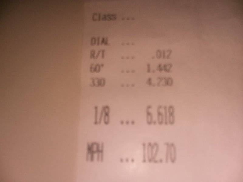

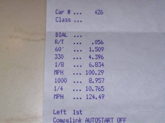

I also leave when I see the last yellow come on. If I am paying attention I can usually cut better lites then this .056 as this was a time run. I have noticed that some tracks are different as it seems at one of the tracks I have run if I leave on the last yellow I redlite so I have to see a tad more yellow. But I don't race a lot so I don't consider myself a killer racer on the tree since I only race once or twice a year. Ron

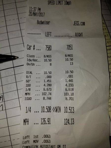

Bracket racing can be a very humbling sport, and don't let anyone fool you, you always need a little luck to get a win. I've posted this time slip before to show how easy it is. lol
