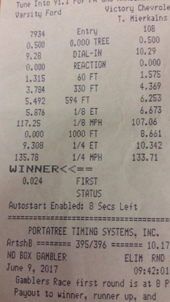

Bracket racing can be a very humbling sport, and don't let anyone fool you, you always need a little luck to get a win. I've posted this time slip before to show how easy it is. lolView attachment 923080

Wow man! You won because of your RT, period! The other car was quicker at every measure mark.

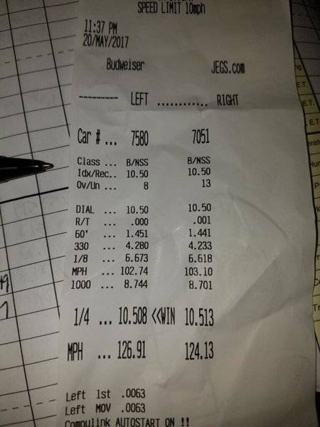

#7580, next day 2nd round my opponent (different driver)went .000 on me, tough crowd. And yes we are footbraking with no electronics. As I said it's a humbling sport
Very humbling sport. How tough is it? I run NSS Guy on a regular basis.

Two awesome racers there. Its a shame someone had to lose that race. Nice job. Ron

This is the 4th time in my career my opponent has gone .000 against me. I've won all 4. But this one had to be a heart breaker. Doug
@dvw, Doug, can you explain what the 594 ft clock is for? I thought it might be something metric, but it doesn't appear to be. I haven't seen that recorded at strips here on the west coast. Maybe they have and i just haven't noticed.
Edit: it looks like your opponent lost that race in the first sixty feet, despite the killer light. His sixty foot is very soft for that e.t., as is his 1/8 e.t. for his mph. I would guess he spun pretty good, and couldn't run the number.
At this track spin is always a possibility. That's probably why mine is only dialed 9.28. 60ft is off at least .05. I tightened up the stripe to probably 3 1/2 ft or so, killed 10-11mph. 594 is the speed trap line for 660 (1/8). They use in the 1/8 like 1/4 guys use the 1000. If you lift you can project your actual ET by using math.
