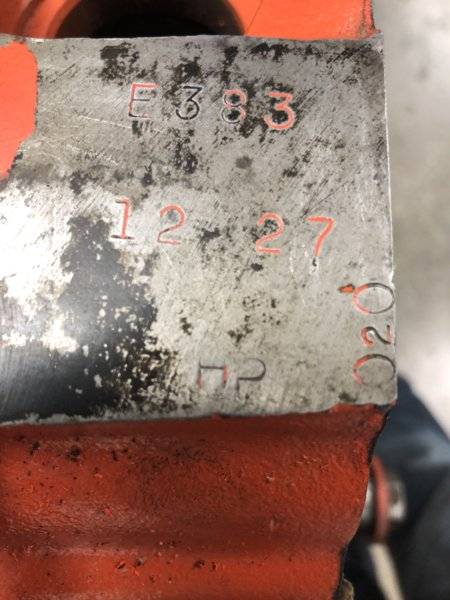

How to decode Engine Date code stamping?

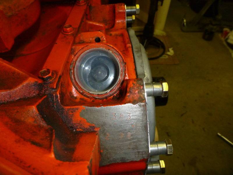

The existence and location of that number pad indicates a raised block (413,426wedge,440, an rb), therefore it can't be the original in your 383 car. Low blocks have a different pad In a different location. The "E" for 69, assembled in 68, because a middle of November assembly in 69 would be for a 70 model car. A 69 rb would be a 440.

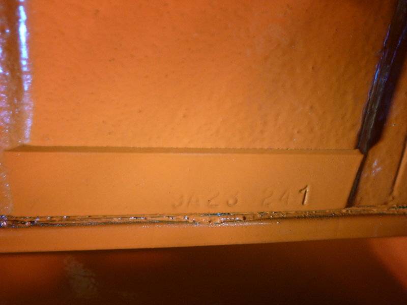

Just above the oilpan rail on the passenger side should be a number with year, assembly plant, and partial vin code of the original car.

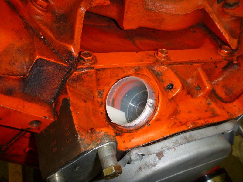

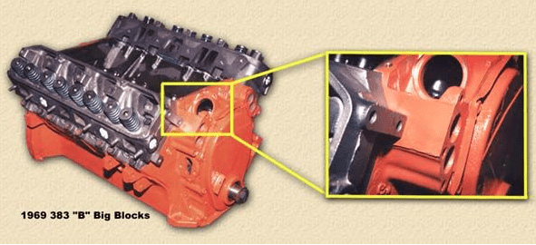

Thanks for the help! I also have a 1970 Charger which was a factory 383 car, and when I went to look for the plate; it wasn't there! Going from what you just told me, of which engines have the stamping there; that explains why... Do you happen to know where its stamped on 383 engines?
Look at the block deck (Head gasket surface) below & forward of the distributor..

VIN partial is down here just behind the passenger side engine mount.

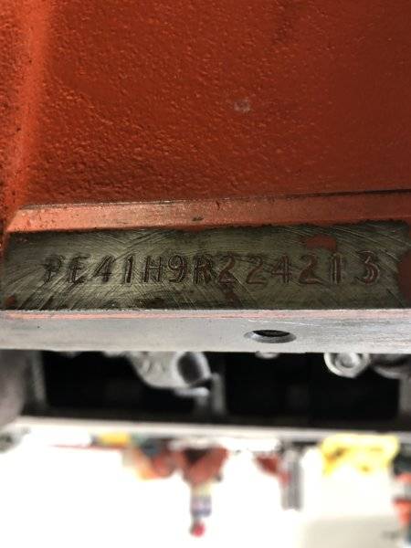

"R" is the Windsor Ontario Plant back in the day.
My Bee was a "built for Canada" Car, off of Lynch Road in Detroit. Have the correct radio to prove it! LOL
@dadsbee is correct. R is for Windsor plant. My 69 runner is also Lynch Road car built for Canada, sold new in Vancouver, and has the full vin on the block.
Maybe I should double check tomorrow to be sure as I haven’t looked f9r so long maybe I’m remembering it wrong.
