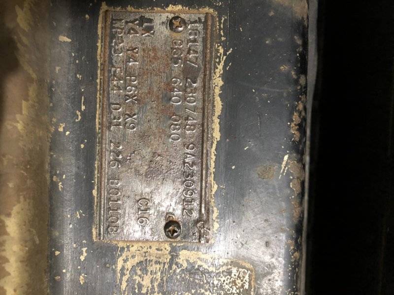

Can anyone help me determine the build date of my car? I tried an online decoder but it told me I have a Polara lol
I’m gonna say the 226 is the scheduled build date. Which would be Feb. 26th 1969
Correction to the 1969 instead of 1968 as listed below.
February 26th 1969.
Car is a 69 Coronet 500 2 door hardtop 318/904 console black bucket seats. Y4 gold with a black vinyl top.
Both our cars "built for Canada" BTW.. that's designated by the "B" in front of your order number B01108. USA cars have a 0 there.
I don't mean to hijack, but.... simple question. Other than the first four places on the bottom row, that designate brand and trim level, are the rest of the codes the same for plymouth and dodge, assuming the same assay plant? Could I use plymouth info to decode his dodge, and be right?
I assume you have a 1968 model, as the fender tag has the SON and does not have the complete VIN on it. so 2/26 of 1968 was the projected build date.
Top right 9A tells us year and plant, 2 digit paint and vinyl top codes are 69 only.
This is not a 1968 fender tag, they had a completely different layout.
It is a '69 Lynch Road tag. Take the WP23 from the bottom left and add to the 9A... at the top right and there's your VIN

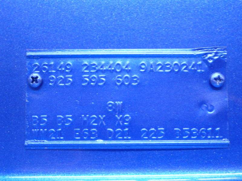

all my 69 tags (4) have the vin on the bottom right of the tag. did not ever see one at the top.
The day after mine and 671 cars ! But take note, my engine wasn't built until Feb 28th, so it was a "scheduled" build date.. not actual.
And cars were not built in vin order.
this is a Lynch Road tag, VIN code A, they are oddball and on their own.
And the 925 says 383 four barrel, manual trans, heater, 335 hp, painted orange.
