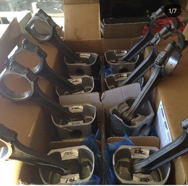

Had my pistons assembled by my machine guy. I took the old pistons off the rods with my press. Sent the new pistons, rods and new wrist pins to him so he could assemble and balance everything sent with my block crank and all. I did final assembly of the engine. He just did all of the work I was afraid to do. lol

I’ve done this using the oven in the kitchen while the wife was out. Made up a fixture to stop the pin at the right point. Put the pins in the freezer too. Went pretty well. One pin stopped early so I used a press to nudge it the last little bit. No magic here, just CTE and care with the heat not to get burned.
