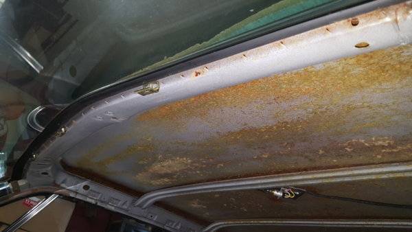

I have these clips along the inside of my windshield, along the top. They are there to install the trim to.

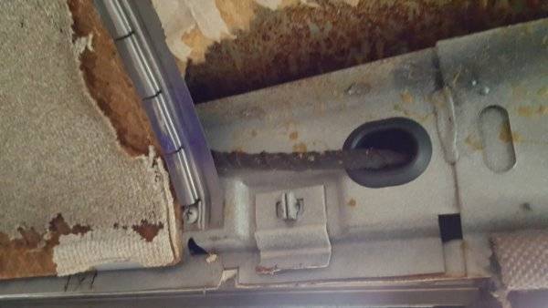

The problem is that one of the clips wasn't in place when I removed the trim. Looks like the factory missed the hole, being the one tab on it was bent.

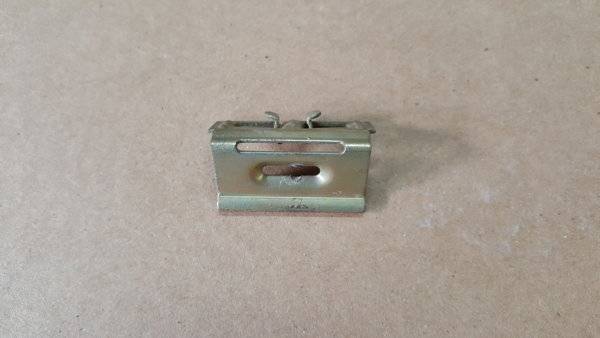

Anyone have any experience with installing these? They don't have memory like a spring. When you bend the tabs, they stay and don't return. Has to be a trick to them. (1962 Dodge)
I think you put it in the hole and squeeze. That spreads the fingers out.

I think you may be on to something there. Looks like I'm going to buy myself a pair of 90* angle needle nose pliers. They are right up against the windshield.
I'm only going to get one shot at this because straightening out the bent half, it weakened it.

That is how they operate....You want the tabs that go into the hole to barely get through and then squeeze on the outside and that locks them in place....
The hardboard headliner clips were installed with the same type design. I just wasn't seeing it, thinking that squeezing them would close them up but they're on a pivot, so that's the ticket!
