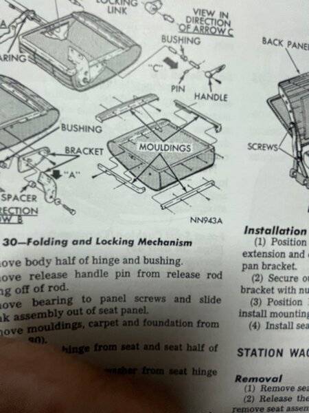

I bought a set of new seat covers from Legendary and they were delivered a few weeks ago. Looked in my service manual "Body & Frame"pages 23-57, and did not see any reference for front bucket seat dissambley. I see that the rear bucket seats have a detail on the removal of the trim pieces, see attached diagram , which appear to need to be pried out. But nothing on removing the larger trim pieces around the front bucket seats.
Does anyone on this Forum have experience removing the old seat covers and trim pices on a 67 Charger? Thank you in advance.
I agree, I re-did my seat foam last year. There are just a few screws thru the trim into the metal of the sat frame. It will be obvious once you remove the seat.

The seat back panel has 2 screws at the bottom. Slide it down, then you can access the emblem to remove it.
After you get the sliders off you will see all the screws for the side covers.
Be careful sliders are loaded with spring pressure.
-Remove the hard back trim on the seat back. Tilt seat back forward to expose 2 screws on bottom. Slide seat back panel down. Get this off first to avoid damaging it.
-Remove the seat tracks
-Remove the side trim on the seat bottom, cannot do this first because a screw is hidden under the seat track.
-Remove the pivot bolts for the seat back
