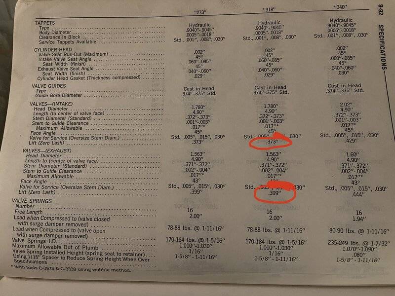

Oh man I didn’t know 318 stock cams were so mild.
240 248 advertised duration, .373” & .399” lift
It that engine has the original timing gears you’ll want to replace that ASAP before pushing the engine at all.
they have nylon coated teeth that break off, and the chain could skip a tooth and bad things can happen
