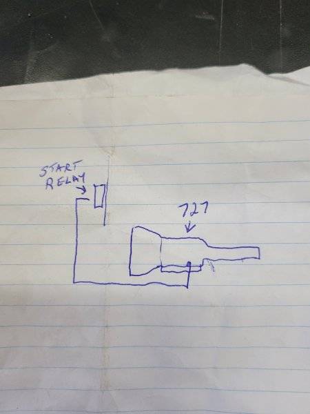

the car was a stick shift car and there was no pig tail but my automatic transmission has the adapter but no 3 pin wiring I have to figure out a way to run the wire from the shifter to the neutral safety switch on the firewall

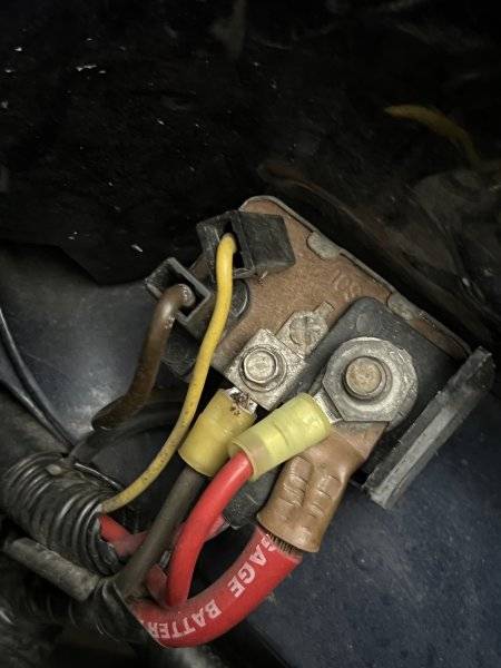

okay so run a wire like in the picture you sent me and to which terminal on the relay ? THX for your HELP
There should be a thin yellow wire going to the bottom of the relay. Right beside that.
If you still have the original 4 speed relay, that terminal will not be there, but it it will be shorted to ground on the relay housing.
So you will need to get an automatic relay.
Lower, right hand terminal goes to transmission safety switch.

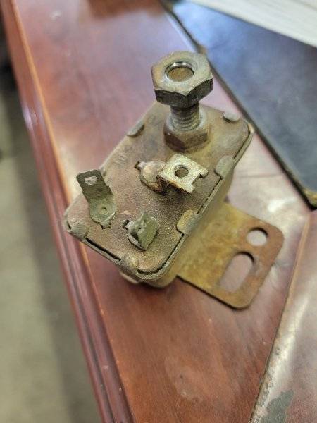

i have a automatic relay on the car now
for one it’s mounted on the fender well and i will have to remove some of the plastic wire loom and trace it to where it goes
