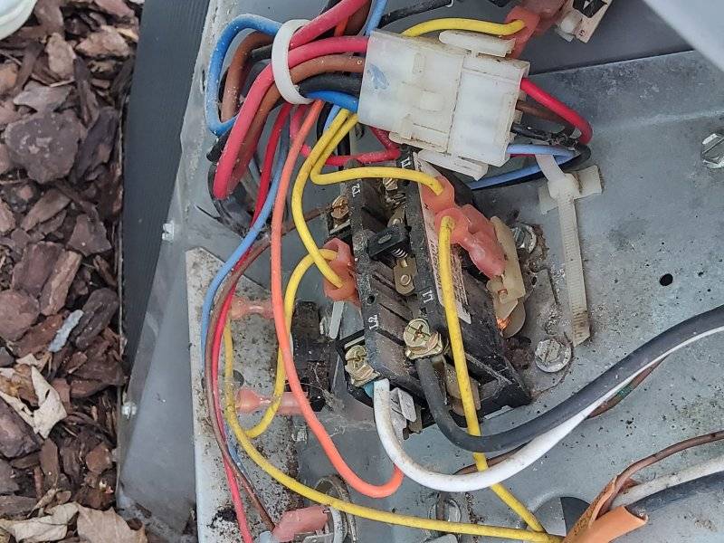

Hi need some help,I just tried to fire up the A/C unit.will not start up nothing not even a Humm.so I started poking around and found in the picture there is a switch once I push it down it all works great, but once I let release it nothing.no reset button either. Any thoughts before I call a Tech thanks.

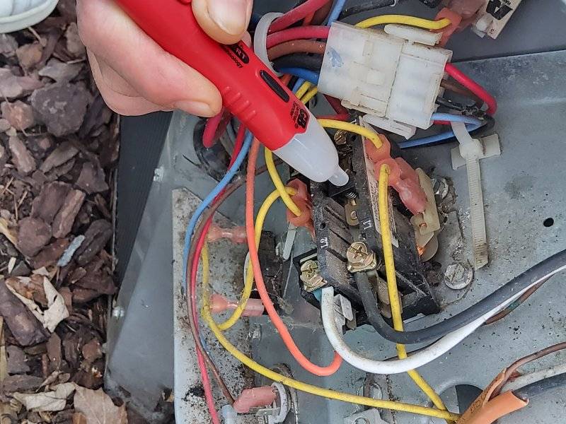

That is your contactor. Check to see if you have 24 volts across the coil. If not the problem is upstream. Either the control wire is bad, thermostat not calling for cool or the furnace mother board is not passing 24 volts outside.

Thermostat is calling for cool that much I know.

The capacitor has absolutely nothing to do with why the contactor isn't being energized. Not only that, but the op stated that by manually pulling in the contactor, the fan and compressor started, which proves the capacitor is good.....

calling the contactor a switch tells me this job is above your pay scale!

If it does check for 24v ac volts at small yellow wires on side if no power follow wires may have a manual reset high pressure switch if so press little button in center
Also could have low pressure switch open as you had a leak check for 24 across switch

Up date it was a low pressure switch. thanks for all the great advice.
