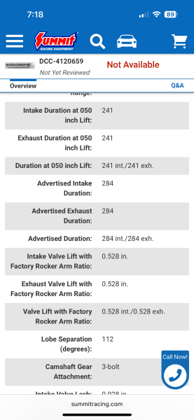

The disco’d mopar performance .528 solid cam seems to be about as hot as you can go with stock exhaust manifolds before cam overlap starts working against you and killing power. I’d try to find something close to those specs. Shoot for about 230 @.050 duration on a hydraulic.
